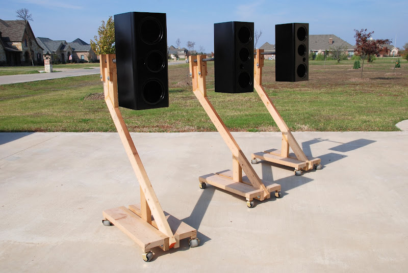

                I made some paint stands for some boxes that I made, which allowed me to spray all sides at once.
                In the first photo, you can see 2 blocks, which were used to mount the box to the stand.
                Both blocks go inside the box through the crossover cup hole.
                The pine block has a slightly smaller hole in the center, just the right size for me to thread a short piece of Black Pipe into.
                The second block has a feed-through hole for the black pipe, and a screw in each of the 4 corners.
                The 4 screws had the point ground down flat.
                The first block rests against the MidRange Chamber inside the box.
                The second block sits over the first block, and the 4 screws are tightened, spreading the two blocks apart, putting pressure against the rear wall of the box.
                The black pipe is threaded into the inner block and the pipe is mounted into the paint stand as shown in the second photo.
