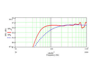

    Greg,
    They'll play louder than I want/need them to...
    Simulations from Martin King's Quarter Wave worksheets show a sensitivity of ~96.5 dB/w. As to attenuation due to baffle step, I must defer to Pete who understands the x-over much better than me.
    The cabinet is tuned to 28-29 hz.
    The division lines (green) are 2 dB apart.
    HTH

    Ed
    Can you please tell us about your alignment of the 2512? How loudly do they play.
