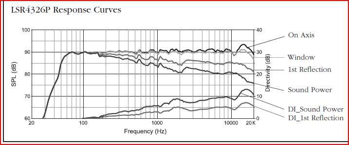

                            Attached are response curves of two well known speakers. Guess which one sounds shrill and you need to cover the tweeter with tissue paper, which one sounds natural?
