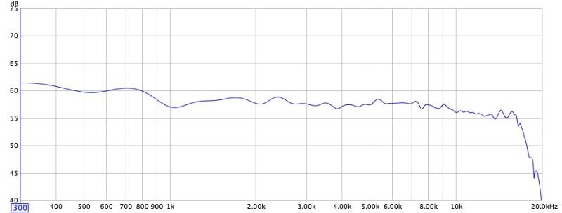

              Zilch, look at the AVG response from the horizontal polar graph:
              Careful AJ, you're treading on eggshells. Deward gets upset when people mistake the B2030A for the B2030P. Well maybe that was just earlier in the week.:rolleyes:
              Dan

                I am trolling you.

                        Is the B2030A the one "flat" measured at the listener position? That would be a rather remarkable design. I'd like to know how to design a speaker that does that, regardless of the room, modes and distance, etc, etc. :D
                        Too late, my point! :p
                        It's NOT flat in-room, rather, downward-tilted, which Dan has just affirmed by showing a calculated power response plot....
