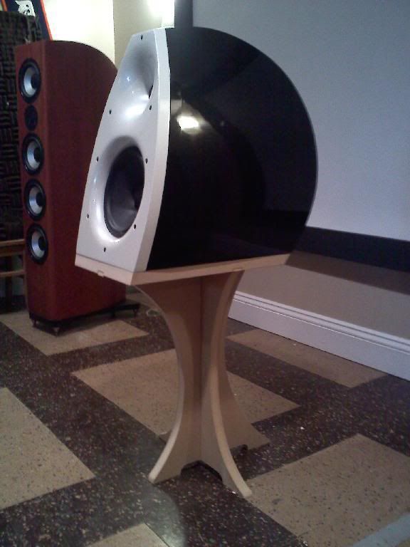

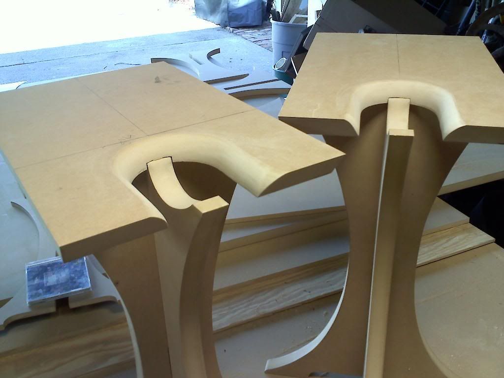

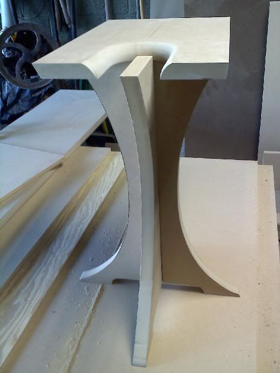

        • Re: MiniByzy (Mini Byzantium) Build Thread
          Ed's making some matching stands. The unfinished prototypes are below. He's scooping out just a bit more material on the upright piece below the vent.
          The upright pieces are to be painted to match the cabinet sides, the top, to match the cabinet baffle.
          What do you guys think?
            My first impression is they're beautiful by themselves but don't integrate as well as they could with the speaker's design.
            I think they should coninue the lines of the enclosure to the floor, and the back leg does this well.
            The front and side legs need to have a little better "flow".
            Make sense?
            EDIT:
            The more I look at it, the more I like it.
            I think if you moved the "toe" of the front leg further forward and made the curve like a bass clef, you'd be right there.
            https://www.facebook.com/lowecustomguitar
            www.lowecustomguitars.com
              Originally posted by BeeTL View Post
              They're beautiful by themselves but don't integrate well with the speaker's design.
              Make sense?
              Once the uprights are that same Cadillac Black Diamond, they'll visually become harder to distinguish, and form a more solid shape. I'm anxious to see how that affects the look.
                  Make sense?
                  EDIT:
                  I'll have to pass along your suggestion. It would certainly follow the line a bit better, but the protruding beam might pose some other "tripping" issues. The center of mass of that cabinet is in the back half, actually directly over the vertical beam that runs side to side.
                  But I get your idea . . .
                    Pete, I like the style, but they look very tipsy, considering the weight they support! The bottom of the base just looks too narrow in the pics to be stable when bumped by a child.
                    I have always been a bit concerned with my own Modula MTs on a relatively tall stand.....heavy speaker with little mass under it.....a formula for disaster if there are children in the home. If there are never children around, it may not be a concern, but few homes are always without visiting (if not resident) children.
                    Marv
                      Besides them looking like a hippo balancing on a bar stool, they don't appear to flow either.
                        I'm with everybody else.
                        Where's the 'substance' or 'heft' that
                        the cabinets inspire or beg the stands to have?
                        I would be leery of putting those cabs on those stands.
                          When I first saw them it took me a long time to realize the front baffle was flat and not curved like the other surfaces.
                          I'd suggest the tip of the "clef" should end where the baffle would touch the floor if the plane were extended.
                          It's hard to tell from the angle of the photo if the side and back legs continue the curves that end just above them, but if not, I'd suggest they should.
                          The speakers deserve a stand that equals and complements their beauty.

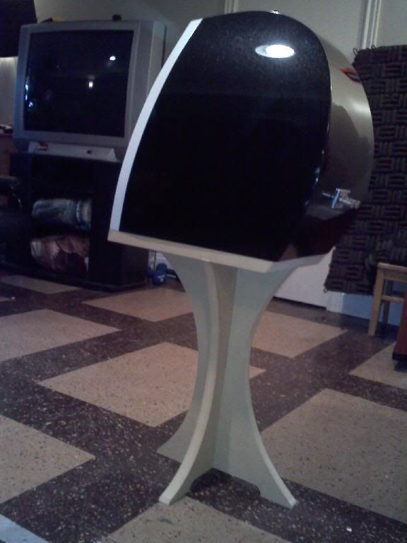

                            OUCH!!! A hippo balancing on a bar stool? HA! I was trying to minimize the stands mass; the speaker shape is "heavy" enough. I've tried different shaped bases; some 2 tube to 3 tube design ideas; nothing seems to fit the Aurora until this one. It may look "flimsy" but it actually is made from 1" thick Plumcreek MDF. Its more like an I beam than a speaker stand. I think it'll hold at least 300lbs. I'll see where it breaks at; I have 700 lbs of weights here. I think it'll hold it all. I'll spray the prototypes black and take pics of them holding up their "Hippos". I think the black will work better than the raw MDF. Funny you should mention the bass cleft; my first design was that exact shape with 2 tubes running vertically through it to hold the top and bottom apart. I couldn't bend 1/8th hardboard that severely. I put too much time in the speakers; spending another 20 hours on fiberglass for stands isn't in the cards.
                            The Past is history. The Future is a mystery. Today is a gift; that's why its called the Present. (Grand Master Oogway, Kung Fu Panda)
