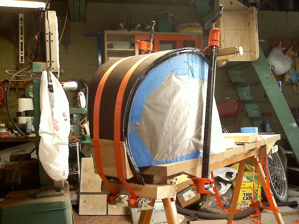

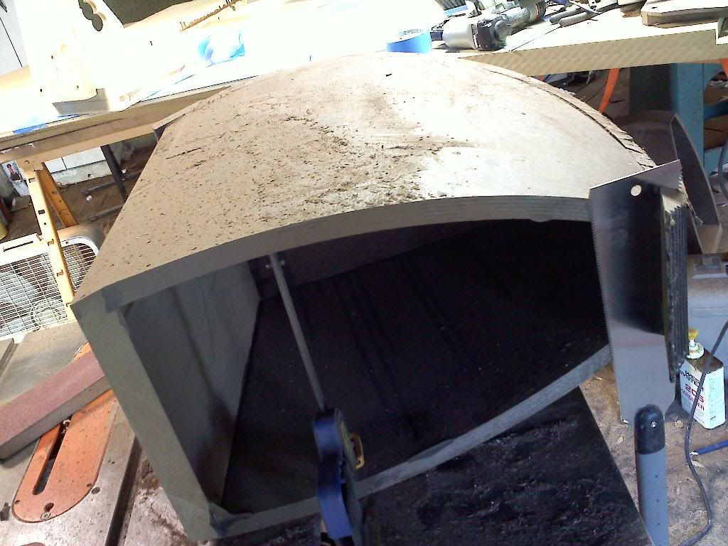

          Strapped down and made to submit.
          Ever wondered what Ed looks like? Here's his best profile.
          Partially trimmed. He's going to be using his Radarcarve to remove the bulk of that excess.
            That's about the best way to do it.... for wood... that is... ;)

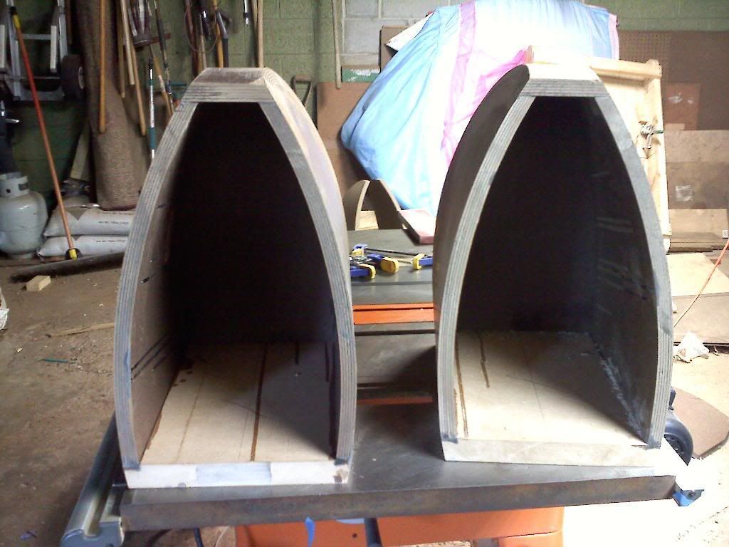

                      • #41
                        Re: MiniByzy (Mini Byzantium) Build Thread

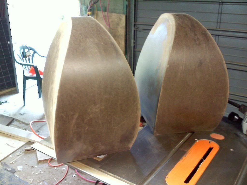

                        A view from the top . . . nice curves. I can't wait to get my hands on them. ;) This looks good from so many different angles. :D

                          Looks great. How were the sides of the top trimmed?

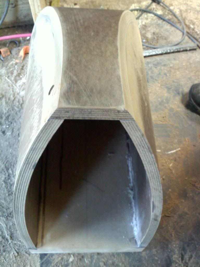

                          • #43
                            Chris
                            Ed used a special hand saw, and belt sander. Much of the material was first ground down with a router on a custom jig/base and spiral cutting bit.

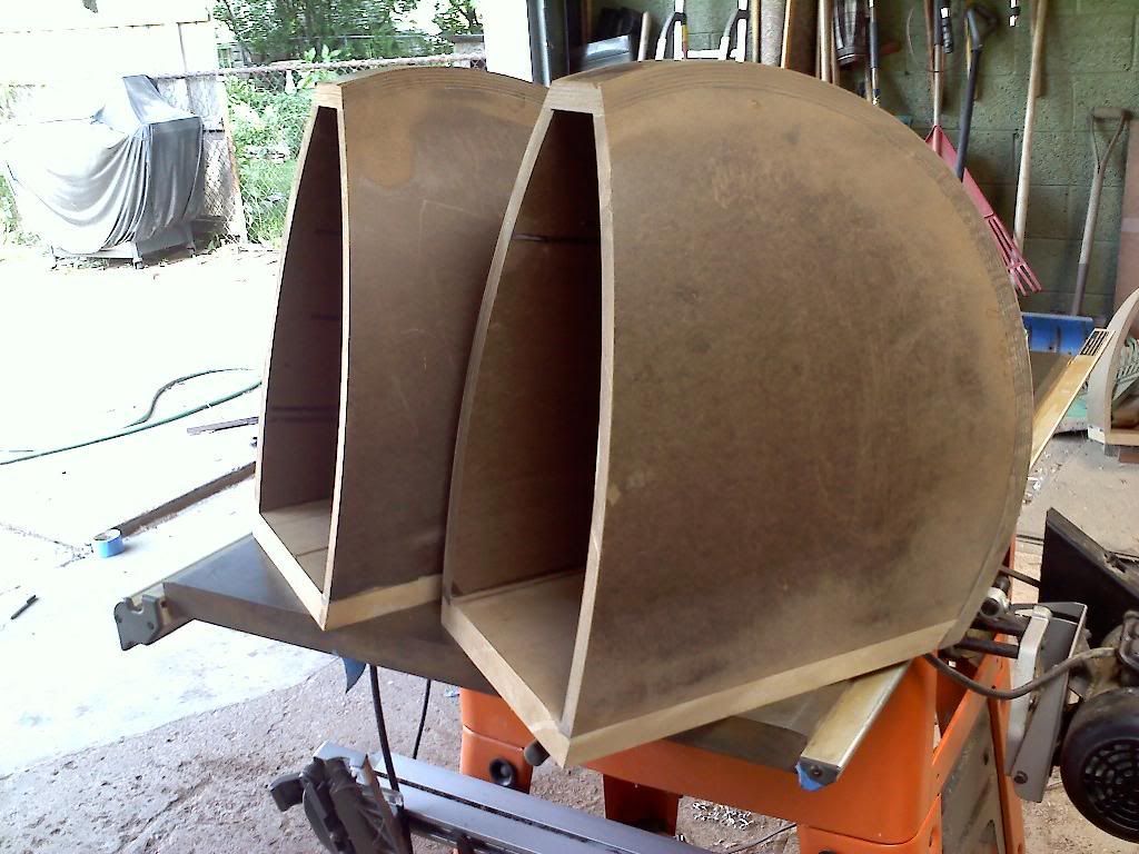

                            • #44
                              Those things are frikken awesome!!:eek:

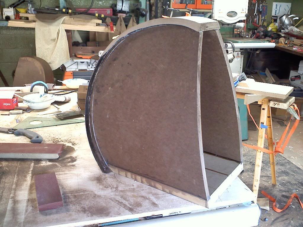

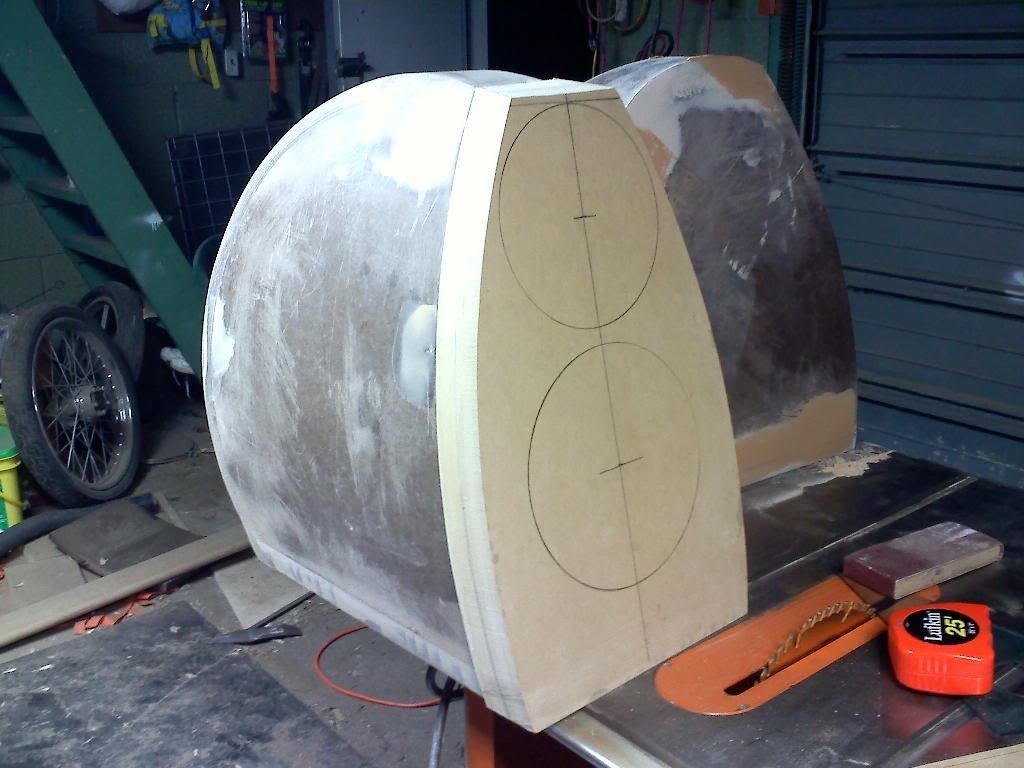

                                Here's a shot of the 2" thick baffle before the wave guide is cut into it. The actual woofer hole will be centered another inch lower than shown, and will include a generous roundover or chamfer.
