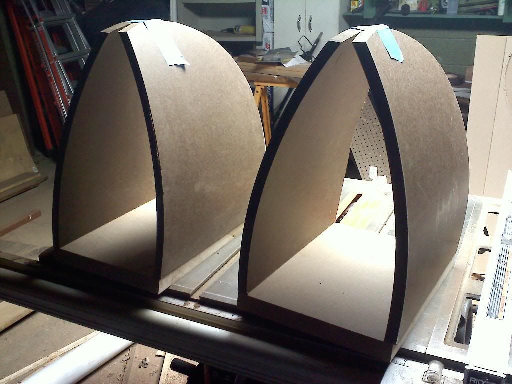

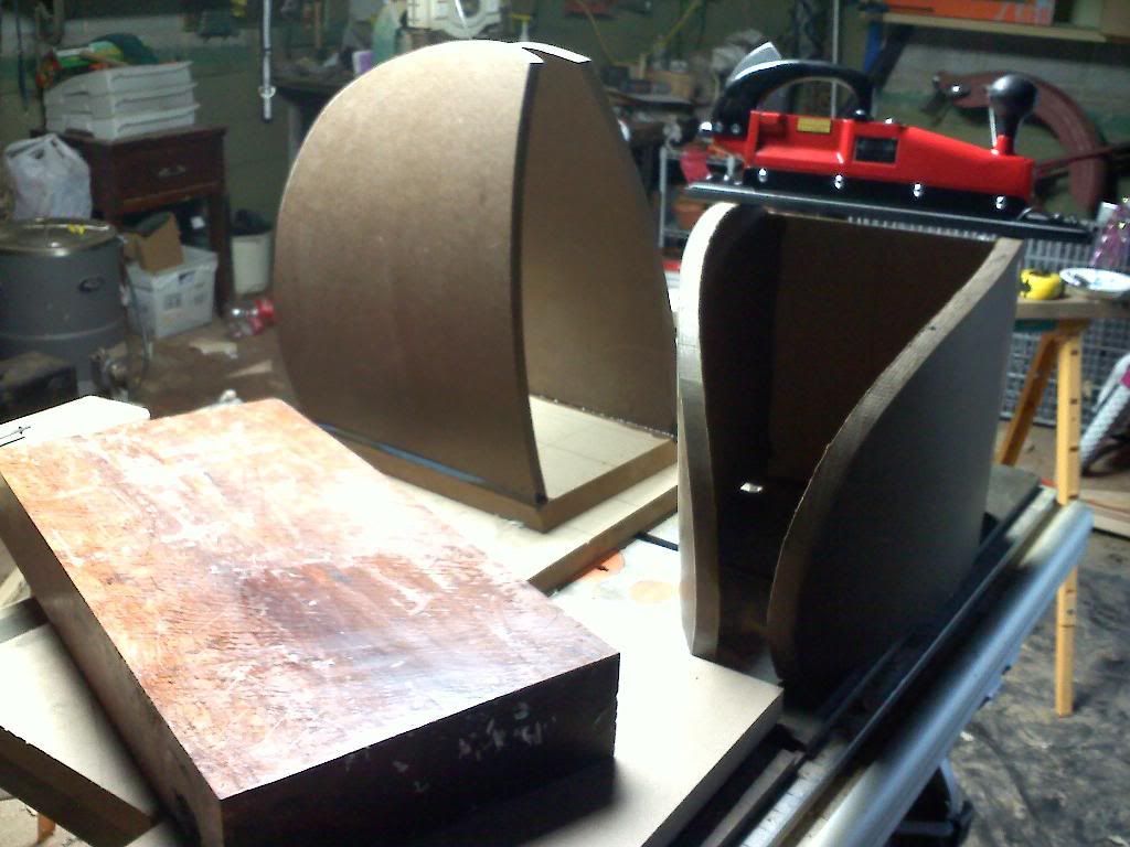

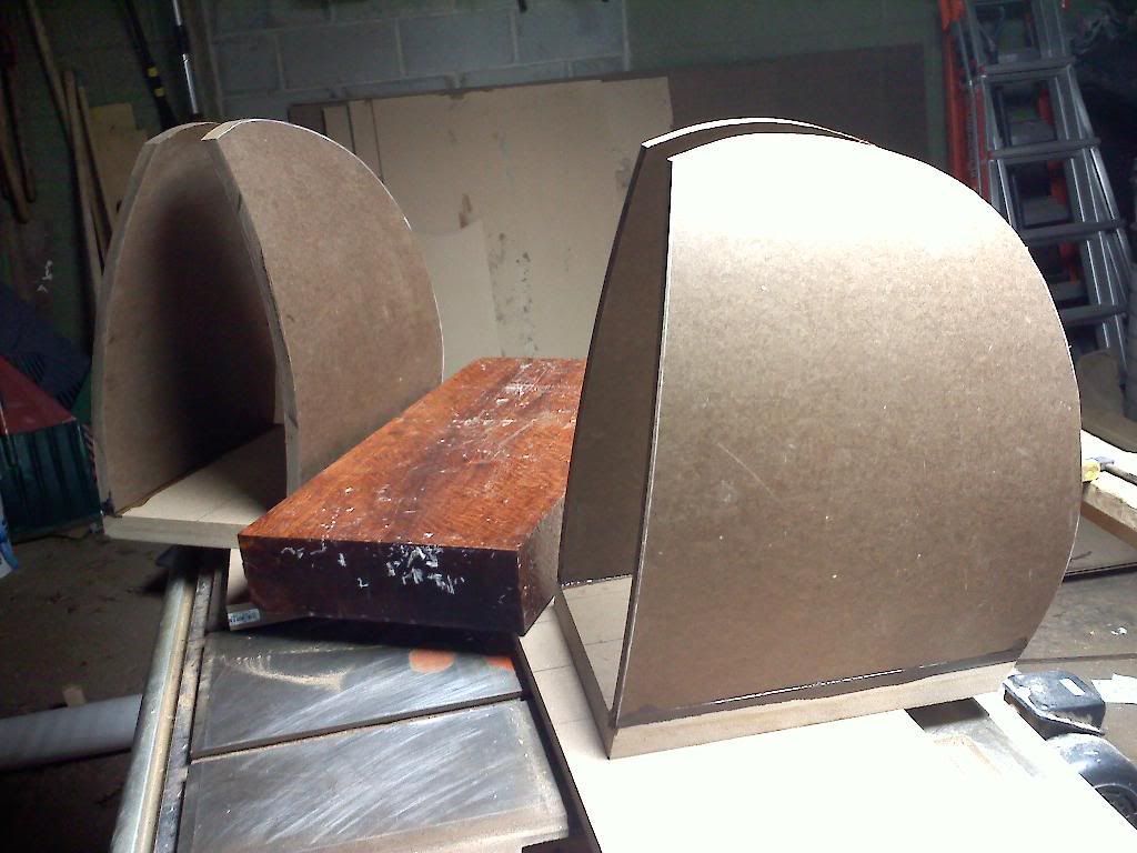

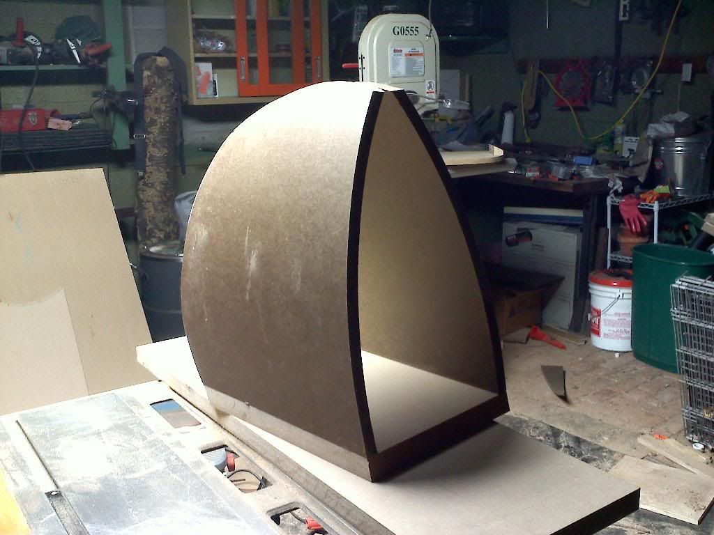

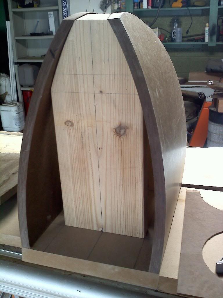

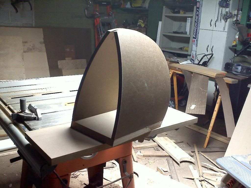

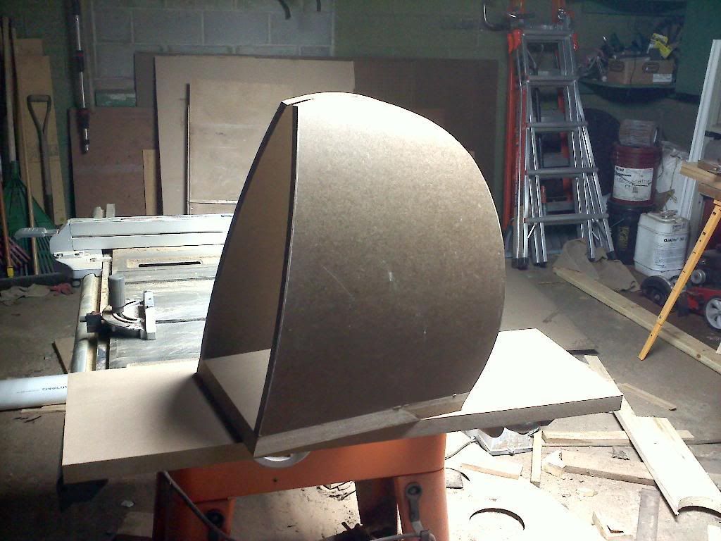

Ed Rosenquist sent me some pictures of the first MiniByzy cabinet construction. So I thought I'd go ahead and start the build thread to document some of the steps Ed's taken to fashion the incredible cabinets we schemed up a few months back. He's mastered the pre-stressed panel construction technique, which results in fantastically strong enclosures. Being a guitar maker has its advantages as well.
Sadly, these aren't for me, but gladly, I get to work on them and listen for a while. You can bet that DoubleTap will be giving his input as well, since he's the source for the Ushers. Should be real stunners when completed. Can't wait to see what hardwood Ed is going to cut the baffles from.
Look familiar? The MiniByzy, 20" tall, 11" at the base, and 16" deep when baffle is applied. Rear mounted woofer and tweeter, with removable solid hardwood baffle with integral 7" waveguide carved into it. Ed says his choice of wood will wait until something moves him when he's in the hardwood store. That will dictate whether paint or veneer goes onto the body of the speaker.
Tentative Driver compliment, Usher 8948A, RS28F. Vent on the bottom baffle. Epoxy/HDF sandwich, pre-stressed, curved panels for the sides, rear/top. Vinyl/aluminum damping on interior walls sealed in acoustic dampening paint. 2" Mineral wool acoustic panels on the sides, bottom and rear.
