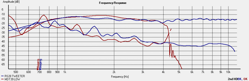

        It's not always a clear-cut decision. I measured an old RS28 tweeter yesterday along with a Morel MDT39. This is at a very high spl, and I intentionally boosted the low end to see how good or bad distortion is at 1k and a little below. With a x-over, both of these get much much better. Reading these HOLM distortions can get a little confusing, but where the SPL is the same, the lower distortion curve is the better one.
        For second order, I'd call this one a tossup.

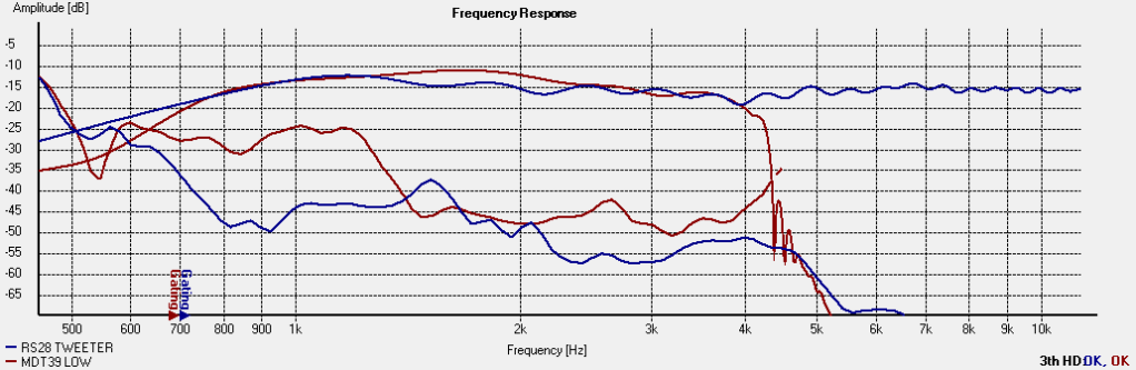

        For 3rd order, the RS28 is clearly better, but I question how much difference there would be with a reasonalble x-over, and at a reasonable SPL.
