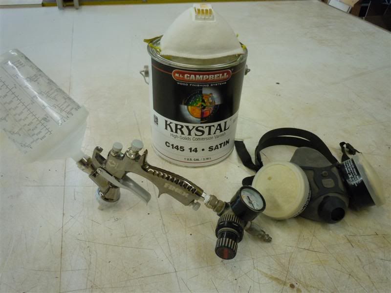

    Hey guys, as talked about in another thread here and a different one in the Gallery, I had proposed to do a thread on "Spraying outside" and achieveing a great finish and I decided to also touch on a few topics about finishing in general and how to achive a "Professional" finish in sanding , staining and spraying outside. This thread will also have a second part coming next week on "How-to" take a cured topcoat and acheive a "Piano Gloss" finish is so desired. So first off lets take a look at some of the tools we'll be using and get this thing started. I kinda worked this project in while I was spraying another Cabinet today so I wound up having a handful going on, so lets go.
    In the first pix is a shot of the gun I will be using along w/ 2 diff kinds of masks and the product we will be spraying. The gun is a "Graco Finex" not the cheapest gun on the planet but deff not the most expensive . Great mid-priced HVLP for wood based finishes. The topcoat is ML Campbell "Krystal" Conversion Varnish. It also should be noted that if you werent using CV and were say using "Lacquer" you could use the exact same procedure here except you wouldnt be adding a Hardner to the topcoat. Also there are 2 diff kinds of Mask. I dont think I have to say which one you should be using but alot of people think the thin white dust mask are just fine, well you be the judge, but I wont risk my lungs on it, use the filtered kind!

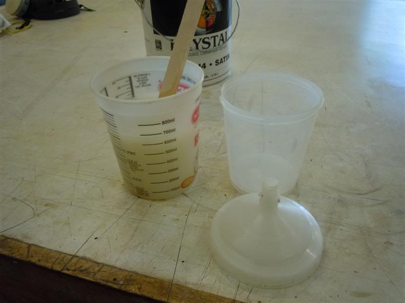

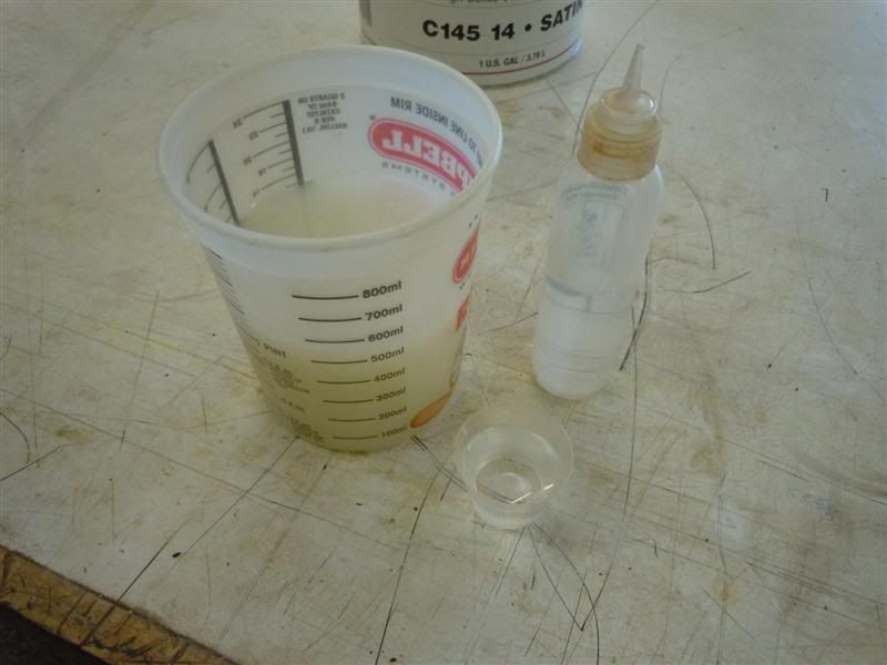

    Next pix is a shot of the actual product and what you will need to get prepard for spraying. We have the CV and in this case a "Satin" finish for sheen, a graduated mixing cup in ounces a mini graduated cup in 1/10 ounces (For the catalyst)
    OT- Cant be spraying w/out a little "Blue Grass" playing ! :D
    Next shot is of the CV measured at 16oz and the hardner measured at 1.75oz and ready to be mixed.
    Mixing the hardner, I usually like to stir for around 2 mins . Also here is a shot of the "Speed cups" I use for product. There made by "Sata" and they have a quick release cap which allows the sprayer to go from ... say sealer to topcoat or even changing colors in just a few seconds w/out having to stop, clean your cup, remix your color or other product. Pretty good little setup.

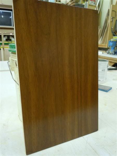

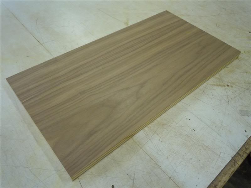

    Part 2, Lets look at what we will be spraying. As stated in another thread Ill be using a piece of Black Walnut plywood which will simulate a piece of Veneered speaker, Its a scrap off of the Cabinet I was building. Now in the spirit of full disclouser the first pix is of the bare walnut. Walnut is very pretty in its raw state. Kinda grayish brown, so I decided to stain it a little darker to draw the color and pattern out a little bit.

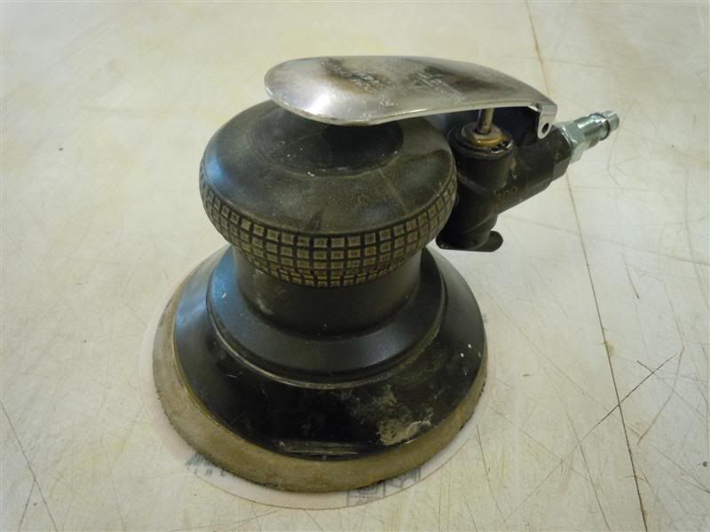

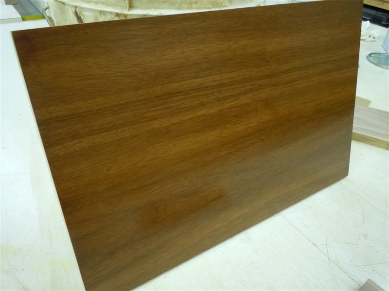

    before staining, it was throughly sanded by and air sander w/ 120 grit to open the pores of the wood to accept the stain well. The sander pictured here is made by "******" this is kinda pricey but worth its weight in gold!! It will run you around $250.00 but when you consider Ive run this sander 5-6 days a week for 11 yrs it is a work horse. It only has 9 moving parts and if you ever wear it out a rebuild kit is less than $30.00 15 mins of work and your up and running again. Believe it or not, I keep all of my air tools properly and as of yet ive never had to rebuild but one in over 20 yrs in business. In this process you will see another air sander, its a Dynabrade and is strickly a "Finish" sander it vibrates and oscillates in microns. You will see it a little later.

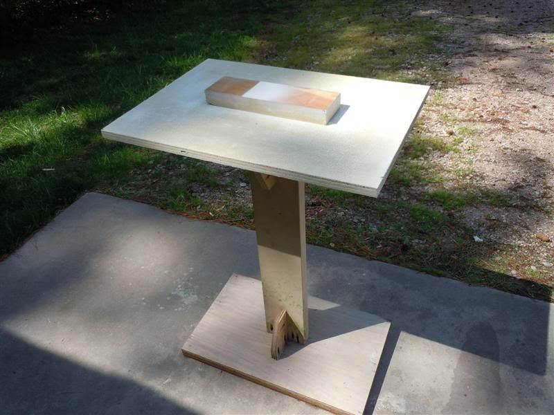

    Here is a shot of the outside carousel we will be using

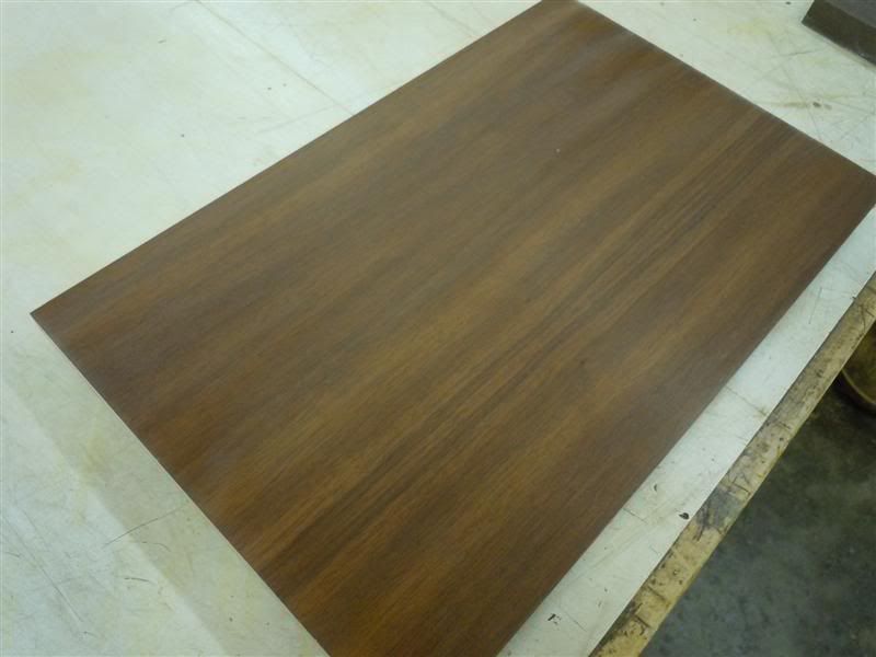

    Next few shots are of our test piece ready to have its first "sealer coat" shot and a pix of the acutal "sealer coat"
    It should be noted that CV is a self sealing product , meaning it doesnt need a second product as a base. Lacquer for instance can be used in a self sealing manner but doesnt have near the "Bite" as it would if you would have used a "Sanding Sealer" as your base. But CV is a wonderful self sealer. You will notice in the last pix, a nice wet coat was shot. You dont want to over do it but you also dont want to spray "Dry" which means your spraying so thin that by the time your finishing the bottom the top has started to dry. Which will result in all of your coats feeling kinda like fine sandpaper.

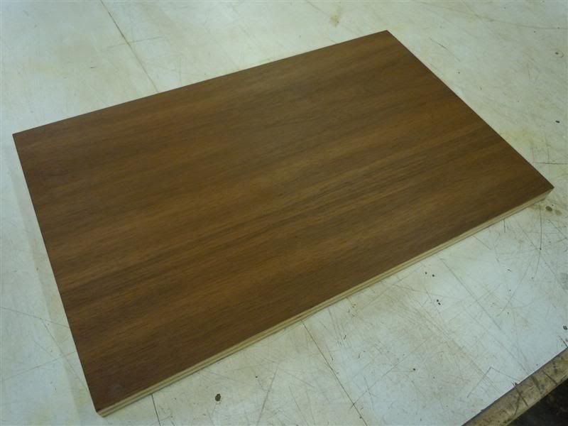

      Part 3. In part 3 we have just brought the test piece back in the shop. From the time it was carried outside, sprayed and brought back in 1min 18 seconds had elapsed on my timer. Not much time for trash to accumulate in the finish. If I was spraying an actual speaker I bet I could shoot everything in under 3 min and have it back inside before trouble could set in.

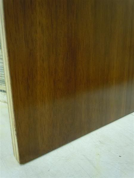

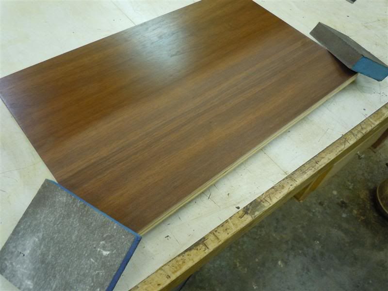

      In this next pix about 35 mins has passed and the sealer coat has dried and is ready to be sanded, this one by hand. It shoud be noted that all sealer coats feel rough. What your feeling isnt trash if you have prepped properly, what your feeling is the grain being slightly raised and the fibers being froze into place. A few swipes of the sanding block will have this smooth as silk. The sanding block are 220 grit.
      [IMG]http://i182.photobucket.com/albums/x294
      /randallkepley/Outside%20Spray%20finishing/Picture038Medium.jpg[/IMG]
      We should take a minute and talk about top coats. There a 2 main kinds of top coats. The first is your products like "Tongue oil" types. These finishes penatrate the wood it self - soaking into the fibers. When dry multiple coats are then applied to build up strength if you will. It also need to be sanded w/ steel wool in between coats not sandpaper. Most of the time sandpaper , even fine sandpaper will leave scratachs to deep for this thin finish to fill and you wind up w/ a less than desireble finish.Now this does leave a beautiful finish but takes a good while to get to your finished product , although beautiful its not very tough. Product like CV, Lacquer, Poly, Paint..... set on top of the stain and dont penetrate into the wood so these products need something to bite to, and what they bite to is the scratchs left by the sandpaper.
      Care must be taken here also because most people think that the slicker you sand the more beautiful the finish will be. This is not true. You can actualy sand so smooth that product like CV ,Poly and paint wont fully stick to one another and will start to lift or seperate after awhile because of nothing to bite. Lacquer on the other hand doesnt work on this principle. Though you need to sand between coats , Lacquer will burn in or melt into the last coat . This is called bonding. The other is called cross linking.

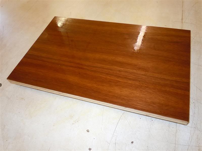

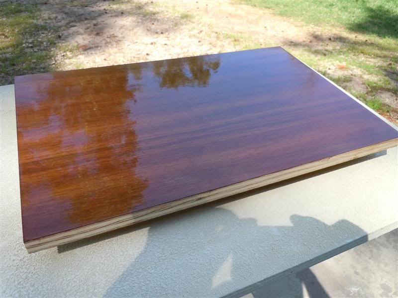

        The next pix are of the final product after 4 coats of CV. You will have about 30-35 mins between coats before you can sand. Last coat will dry to the touch in about 15 mins and can be handled in 30 or 40 mins fully cured, hard as a rock in about in about 10 hours.
        The Beauty of using CV , Lacquer and what not , is the speed in which it dries. The faster you can get something to cure the less likely you are of have air-borne contaminates flaw the finish. The last couple of pix are not as clear as the first. It was around 7:30 pm and my light was dimming outside which lowered the light in the shop. But the finish is superb, slick as glass and very deep. Ill try to take some pix outside tomorrow so you can get the full effect of just what this looks like. I hope this was some information some of you guys could use and I would be happy to anwser any question I can. Thanks for looking. R.K.
