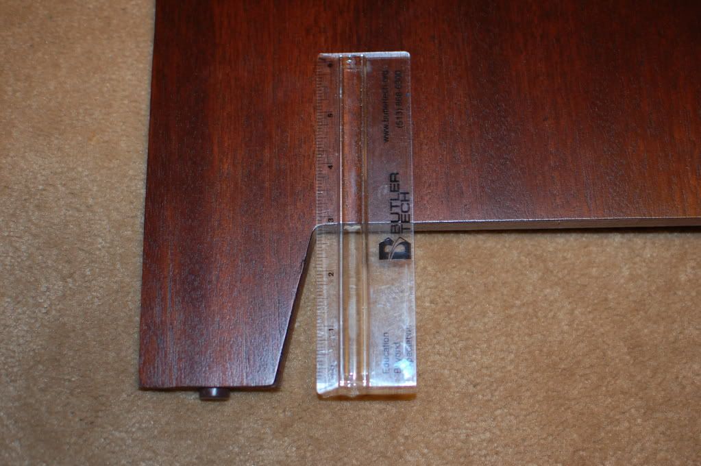

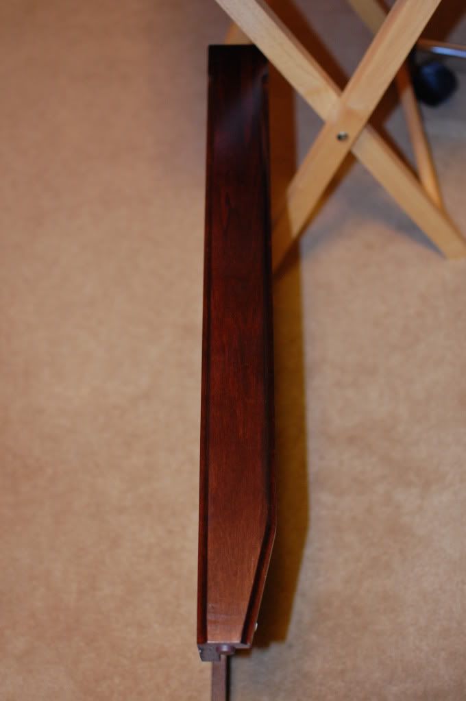

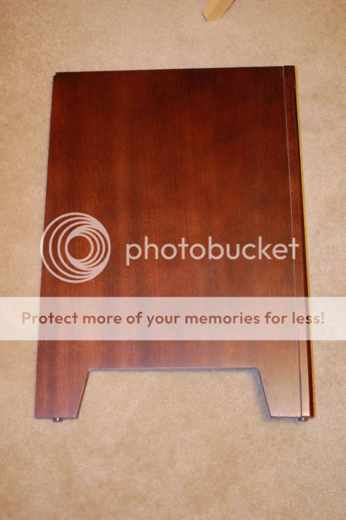

    i'm about to start on a set of Paul's core 2-ways for my brother, and he said he'd like it if i could make them match some furniture he recently got from target. i've got the color and the design cues taken care of, but i'd like the grain to match as closely as possible too. based on the pictures below, can anyone weigh in on what species you think the veneer on this furniture is?

    Hard to say with factory stain on it. My guess is some kind of Mahogany or possibly quarter cut cherry.

      It's African mahogany. Your best bet is to get ribbon cut. I think that your sample is finished without a stain.

        Hard to say under a stain if it's African or Honduran mahogany. Definitely Mahogany tho.

                You'll never match it exactly without stain and/or dye. Most likely the factory used some kind of staining to keep things consistent. It's always easier to make wood darker. I don't think you'll get grain to "match" the best you can do is consistent color.

                  Based on the pictures you posted, I would agree with those that think it's African Mahogany. At the end of the day, I suspect stain and finish is more important than matching the wood exactly. Just my 2 cents....
