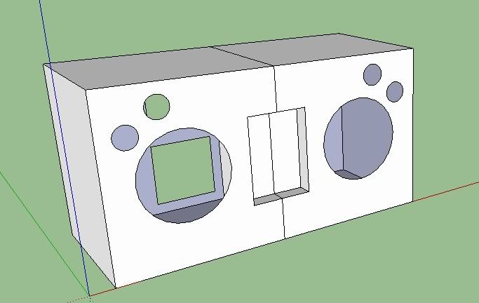

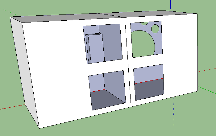

    ok a nice little mp3 dock design
    bit rough
    whats going in

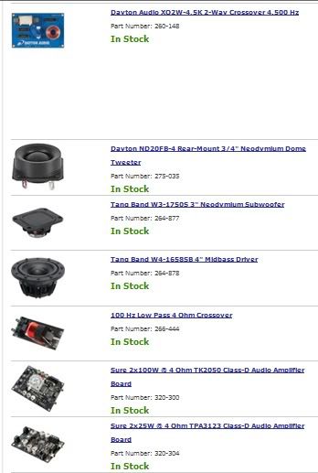

    the 2 tweeters per side will be wired to 8ohms while the mid woofer will be at 4ohms
    the subs on the back will be be on a 2channel and run 4ohms per channel
    the front
    the back

    -Get rid of everything on the front and get a pair of these.
    -Forget premade, one-size-fits-none passive crossovers and get an infinitely adjustable MiniDSP module. You already have the amps for it in the cart.
    -Did you model the enclosure size of those subs in a program like WinISD? I could do it for you, but only if you're at least a bit serious about this.
    Besides that it looks alright...good luck.

      that miniDSP thing is genuenly interesting would it work for a 2channel 3 way or would i have to get 2 one for the mid high and one for the subsonics. they really dont have much for detail on the site that i can find
      havent figured sizes for anything yet this is the rough sketch to get feedback on the idea
      i prefer the 4 inch tang bands as they suite my needs sonicly and cosmeticly
      as those drivers match the look im going for and im going to wrap the box in carbon fiber and then it will have a base under it fabbed from steel (faux-cromed*) and use steel mesh (also faux-cromed) to allow airflow the base will then contain the power supply
