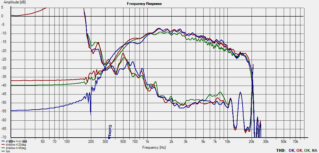

                                Originally posted by [email protected] View Post
                                Sorry. I thought it was the somewhat oval. Shape that Pete liked so much.
                                The throat and opening are round, but the cross section is elliptical. This is the response of that WG with the RS28F mounted to the back with the flange. Absolutely gorgeous with only a tiny wiggle in the response above 10KHz.
                                I'd love to see an elliptical version of this, but DanP was only able to make a few versions. This profile proved to be the best for the rear mounted tweeter w/flange. The others might also do very well if the flange is removed and the dome pushed into the WG. That testing hasn't taken place yet.
