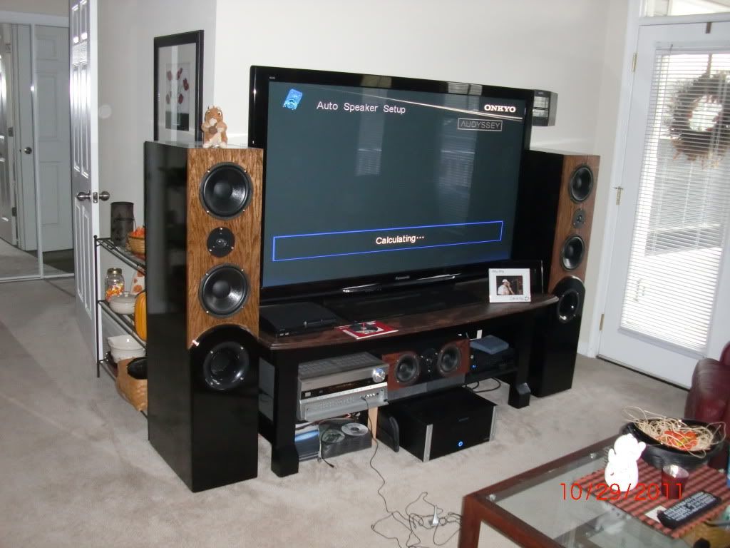

        WOW, those are beautiful! That is really inspiring, thank you for sharing. Yeah, the original design looks really nice, I went with Chris' design because the crossover is simpler and I have a feeling the smaller boxes would be more to my liking acoustically. I love the shiny wood grain on the baffles. How did you do the black finish? I'm still brainstorming on how to finish them.

                Thanks mono! These were the first painting endeavor I took on and messed it up with applying the clearcoat. I was not happy. So after ~$75 in rattle can and countless hours, I took them to an Auto Body shop and had them do the black and clearcoat. Best thing I ever did. $150 and now I can buff and polish these like a car! The $150 was worth it to me since it would have cost me another $50-$75 in paint and countless hours.....
                I do plan on painting my next set myself, but will get them auto clearcoated again. I love the durability and ability to buff and polish. I don't have an HVLP and a big enough compressor to handle the job....
                Good luck and make sure you post up a build thread. This is a great place to start and get assistance.
