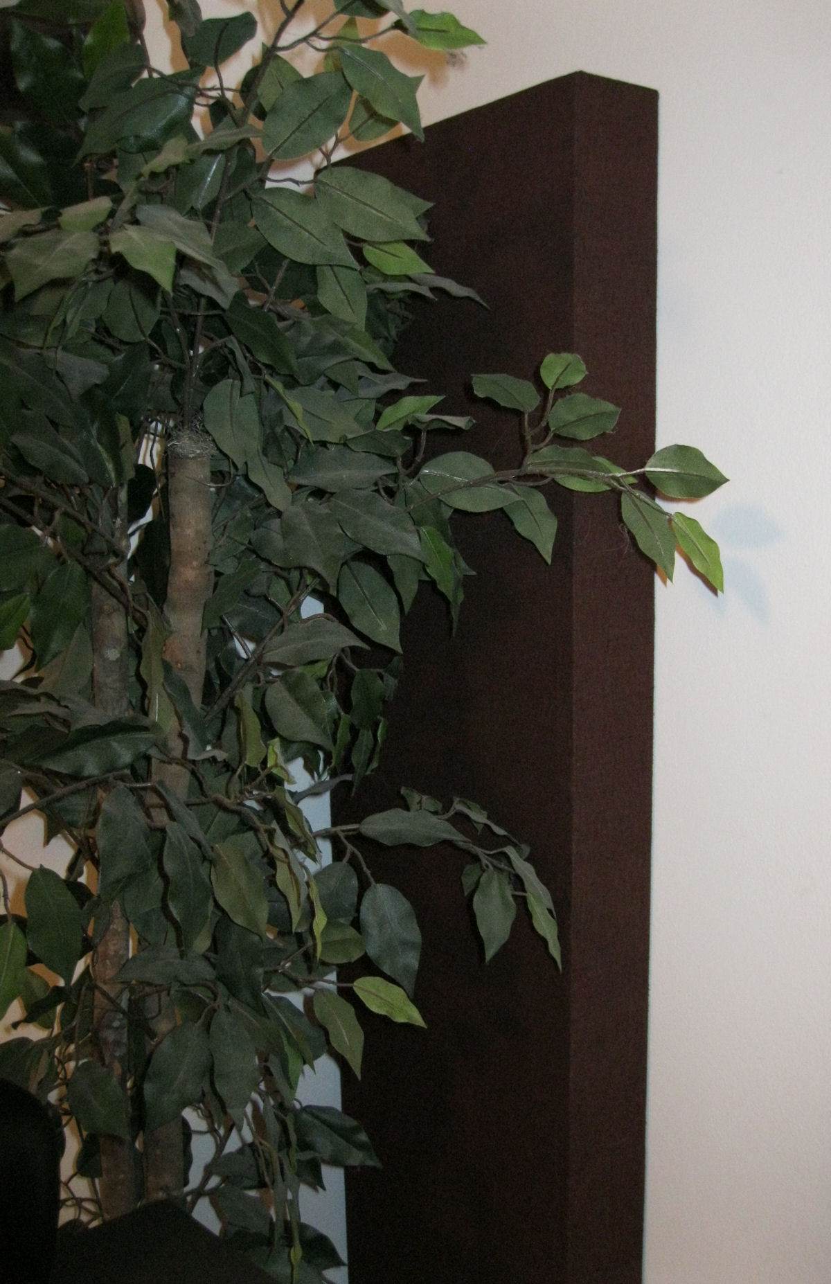

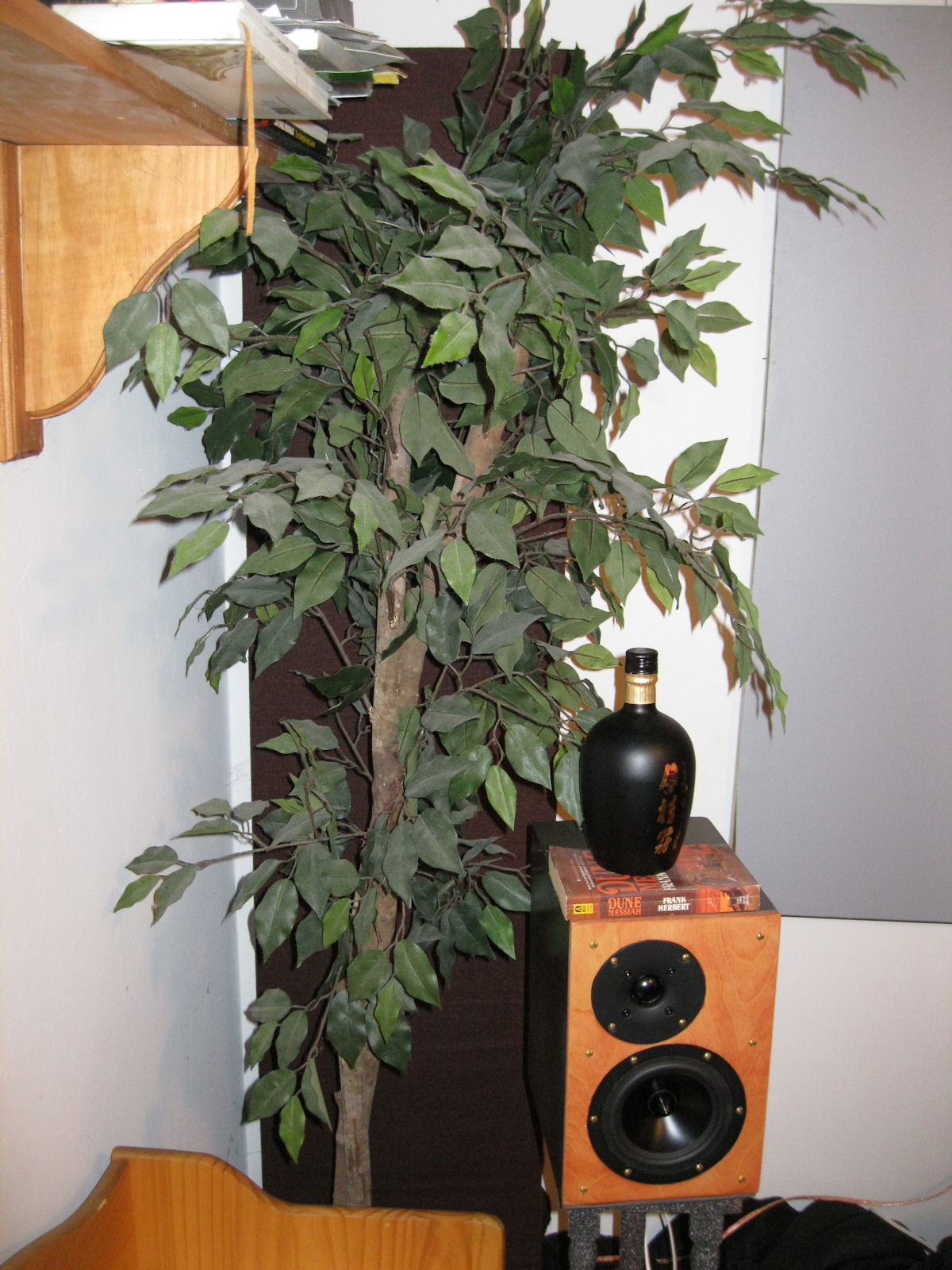

                        I have a home built 92" high contrast grey theater screen for my DLP projector covering most of the 11' wall, so I'm only left with a little space to apply any treatments around it. I'm sure though it absorbs something, since it a large frame with a an underlayment board atop it and then the screen
                        The speakers are 30" out from the rear wall and 22" from the sides, and I think IIRC the woofers are 34" up from the floor.
                        I put the panels right against the back corners flat on the rear wall, as so:

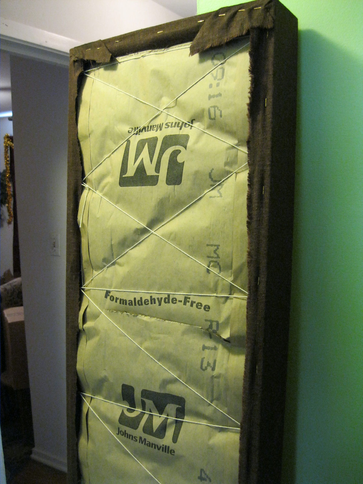

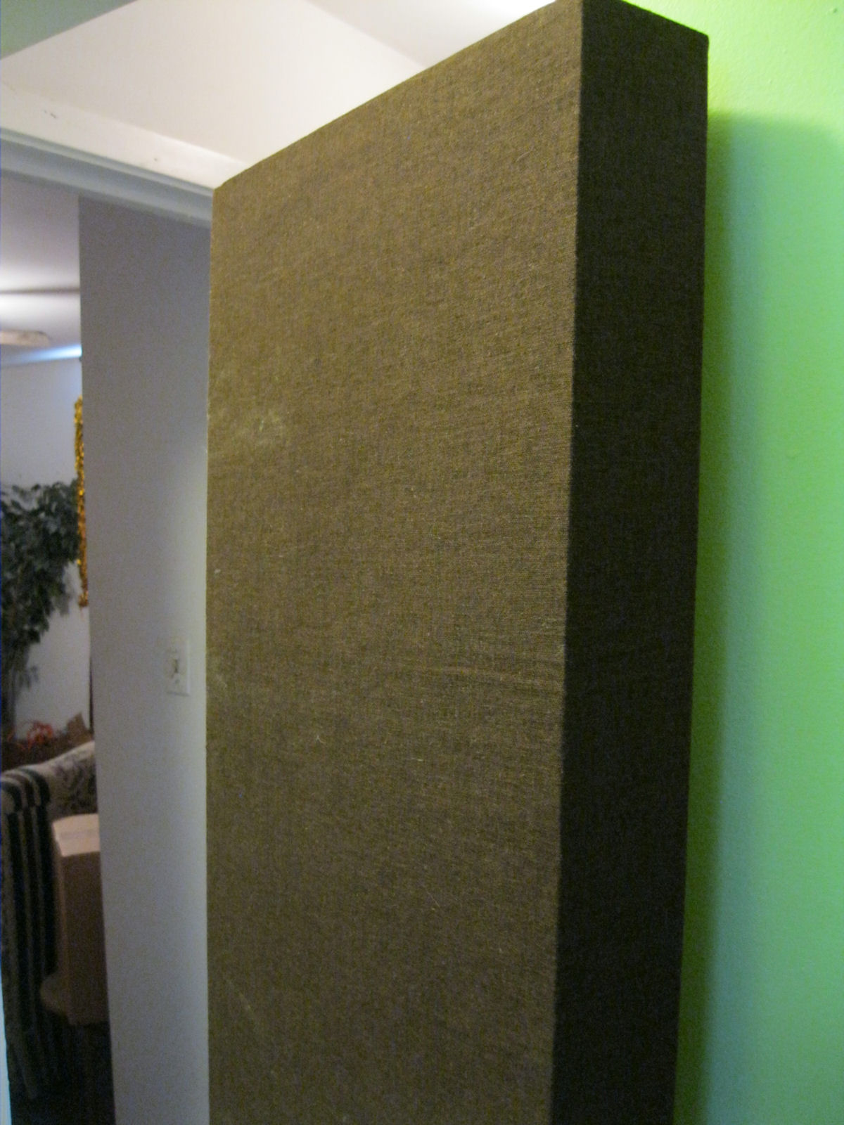

                        Here is a better look at the panels themselves, since they are kind of obscured by the artificial tree (which looks much better in room without a damn flash on it!).
                        As I mentioned before, its a thin linen material over a rigid pine board frame, filled with suspended R-13 acoustic batting (3.5" thick, kraft backed). I left the backing on the side that will be against the wall.
                        Oh, and yea, the book atop the Bento is because: I learned the hard way to model the baffle /before/ you build the speaker. I need +1" to avoid a terrible dip just above 2khz <.< I plan on adding a decorative name board to the speaker there at some point instead of the book.
