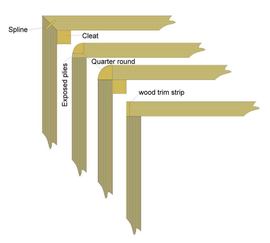

    Hey guys i guess what i mean by the title is how do i cut the plywood i have so i dont see the plies on the ends? i plan to just sand and stain the wood instead of covering it. i dont want the front baffle to have any signs of it being plywood. Do i just miter cut all the joints?
    I have a table saw, circular saw miter saw and my dad has a radial arm saw. we should have it covered as far as saws go.
    How do you guys do it?

    You have to use a mitered cut. I use a 45 degree table saw sled.

        Miter joints are one way. Another way would be to use quarter round. I couldn't find a picture of it, but rather than having one piece overlap another, you cut the pieces just long/wide enough to touch the other and attach the pieces from inside. Use the quarter round to "fill in" the corner joint. Your corners will have a rounded over appearance.
        I wish I had a photo to make my explanation more clear. If I find one, I'll post it unless someone beats me to it.
        One final way is to put trim on the edge that shows the ply.

          I have done 14" T/W and 56" W/M/T/M/W tall speakers with Miters. If you want to avoid an exposed edge you really don't have a choice. Just get corner clamps and practice.

              I agree with the edge banding point, but the quarter round method isn't edge banding and can look pretty nice.

                I have done several speakers with quarter round or square solid stock on the vertical corners. The tops I have covered with veneer, hiding the end grain. The bottoms were left unfinished. A little Zaph mini monitor, that has top and bottom veneered. Schumakubin, top veneered, and Singularity, with floor tile top.

                    I think i understand the quarter round idea after googling it. looks like you would cut it a little deeper to allow the quarter round to slide between the two pieces of wood. Might do that dont look TOO difficult.

                      45 degree miter all edges, all pieces cut to outside dimensions, use packing tape to do a fold/assemble, works pretty well, but the pieces must be accurately cut and mitered. Somewhat tricky to glue/assemble, having two people helps.

                          Lock miter bit on the router table or shaper is another way but takes time and pricey bits.
                          Edging can look nice if solid edge is used decoratively.

                            Roman's suggestion (lock joint) is no doubt the best solution, but I suspect you're looking for an inexpensive method. I don't think you mentioned why you want to use plywood, but I know a number of people that frequent this forum prefer it, primarily I think, because they dislike the dust that MDF produces. But using plywood does complicate construction, as compared to MDF. If you don't have the resources to use lock joints, then mitered joints will be the best option from an appearance standpoint. Note that the quarter round method will require a piece that's as thick as the plywood, or the plies will still show somewhat. But if a size equal to the plywood is used, you'll have to use some method, such as cleats, in order to have surfaces to mate for gluing. Using MDF sounds simpler to me, but if you decide to use mitered joints, you may want to consider a spline, and/or cleats, or biscuit joints.

                              I know you're not kidding, but what makes you think using plywood complicates construction? After the countless threads about MDF edges and the treatment?
                              I'm one of those guys that hates mdf dust, but I'm curious. All materials have their compromises, but I think plywood requires fewer. Granted I always veneer or paint plywood since I think plywood is pretty unappealing when stained.
                              FWIW, a plain miter joint with modern glue is plenty strong enough for a speaker. Splines and cleats are leftovers from earlier days for this application.
