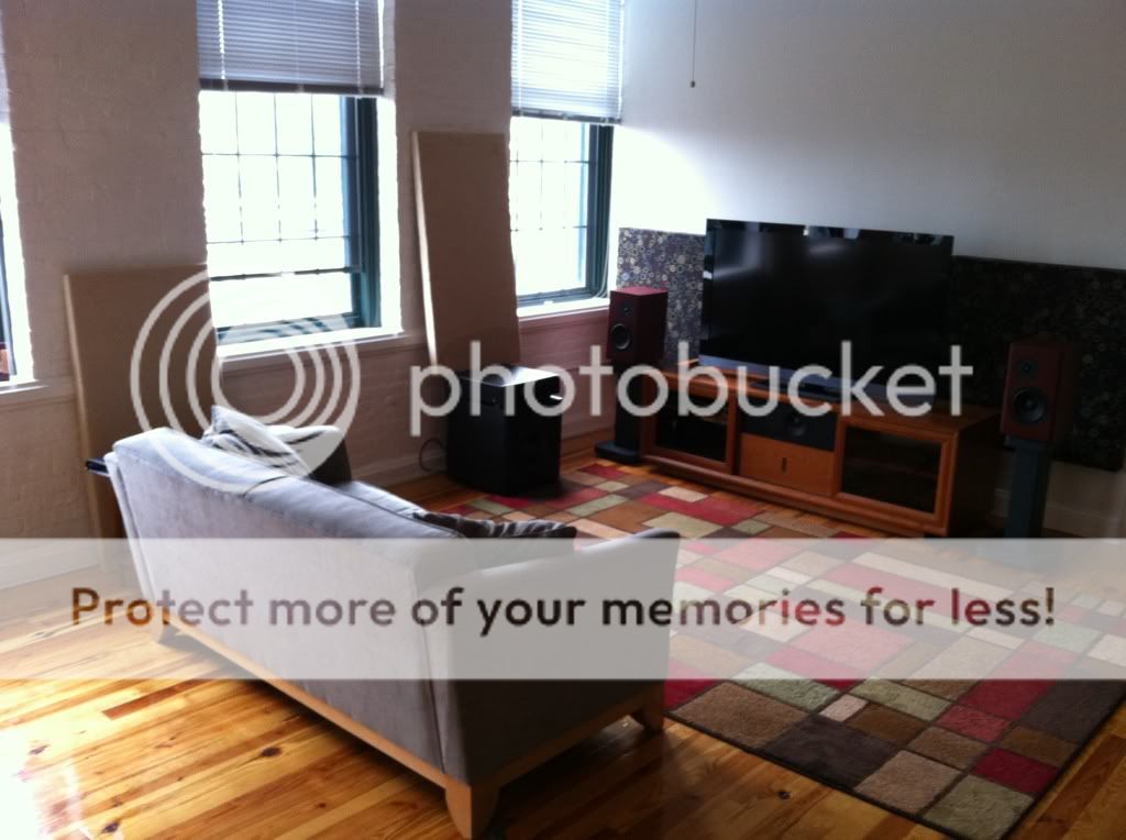

    Here's my living room, if you can call it that... it's one corner of the main room in my loft space apartment... the entire room is about 30' x 30' x 18'
    The sealed RSS315 shown here may or may not remain in the system... maybe as an end table between the couch and the wall?... I dunno...
    I'm about to build a 2.5 cu ft vented sub to take an RSS315, and I'm considering making a coffee table out of it, which would obviously sit right in front of the couch here.
    Would this work well?
    I know, I know, it's probably tough to tell unless I experimented with placement of the sub... obviously I won't have that luxury...
    But what's your hunch? How well do subs typically work when placed significantly far away from any walls?
    Thanks

    BTW, here you see the SR71's that will shortly become The Bombers... the stands seen here will be replaced by the RS270 woofer cabinets...

          No, but not because of the sub. Rather, because of the mains.
          Why would anyone want anything between the loudspeakers and the listening position?
          That just leads to easily-audible diffraction.
          If you want to build the sub into a table, make it an end-table, not a diffraction box.

              I seriously doubt that you will have any audible diffraction from having a coffee table, wether it be sub or actual table, in front of the couch. If anything the left speaker will exibhit diffraction simply because of its placement.
              All that said, I have done a few coffee table subs, and all except for one worked out well. The one that didn't was not due to placement, but the owners expectations being way over the top for what he was asking for originally. I say build it, the cabinet cost you nothing and even upgrading it won't cost very much. Just think of it as a grand experiment. Brace it well as i'm sure that Pioneer cabinet is fairly flimsy.
              The best one I built was a HUGE table sub that housed a pair of 12's in a 6thorder BP. Ports fired toward the TV and away from the listening positions. I braced and double walled it. 2 sheets of MDF I believe and about 220 lbs when it was done. No resonance from the cabinet and he could still use it to put a drink on without worry of it falling over.
                Try it. I was resistant, because of the practicality of a coffee table, but it was instantly obvious that losing it was a sonic improvement.
                If one cares about how music sounds, one learns to put stuff on end tables instead. (And also to keep the area between the loudspeakers themselves as free from diffraction-causing elements as possible.)
