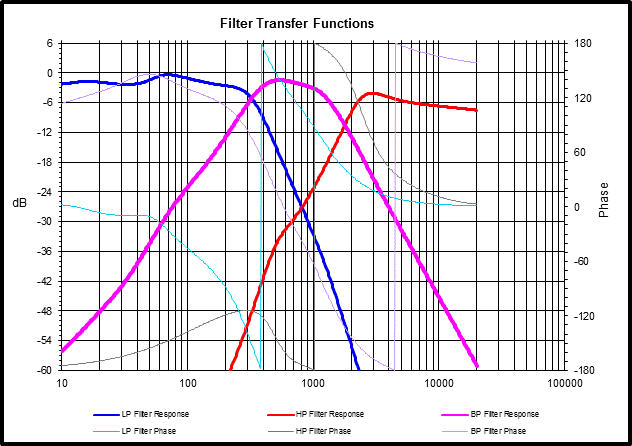

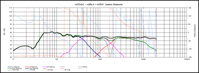

    these puppies are toast. all 3BW slopes, 350 and 1800 all positive polarity. these really reveal the differences in the way the engineneer mixed. reba's voice is amazing as is the singer from sugarland. i think if the breakup on the rs150 was not down enough, they would let me know. i have a cd that a friend in nebraska gave me and all the cuts sound great even the trumpet so i stop here. these should make it to midwest audio fest in the all dayton catagory.

          GLad they are sounding good - too bad I won't get to hear them - rather impressed that you went with a BW3 crossover rather than the usual LR2.
          Did you consciously choose that topology from the start, or did it just happen?

            it usually a matter of getting the phase to line up. the rs150 needed 3rd order to get the breakup down. on my next build i may set targets as 2lr and see how it goes.
