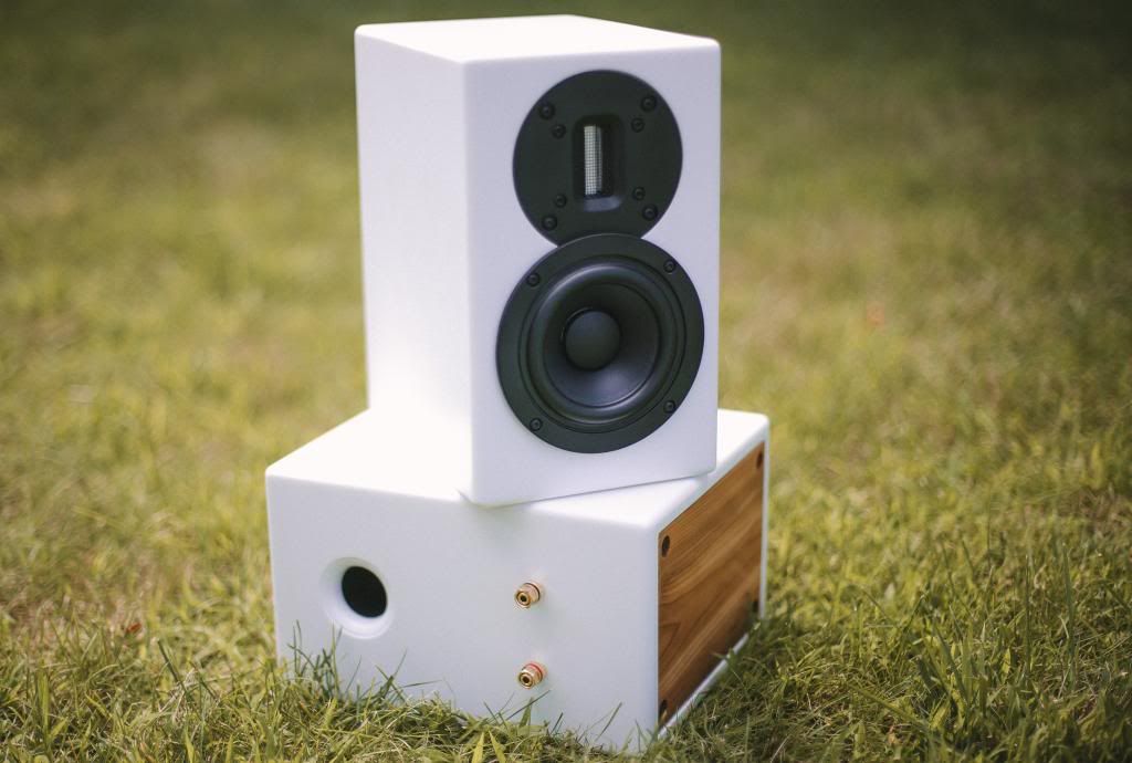

    Hi All,
    Before I begin, I want to take a moment to thank Paul Carmody and all of you within the DIY audio community for sharing your time and knowledge with the rest of "us" audio laymen. I am an Industrial Designer by trade, so my knowledge is limited to Physical/mechanical design, material/finish, and fabrication. I confess that without your expertise, I for one would not have embraced this project.
    Long story long, after spending many years using a vintage pair of Dynaco A-35's and a Marantz 2270 (which I loved both) I decided that it was time to reduce the physical size of my audio setup. With kids I just didn't have the space anymore. I did my research and auditioned Paradigm Atoms, Paradigm Shift A2s, and Audioengine A2 and A5s in my home. I slowly began to realize that there just was not anything on the market that met my criteria of being both compact and deliver on the "full, warm, and lively" sound that I had become accustomed to. Not to mention that as a designer, I admit that I "listen" a lot with my eyes, and most speakers were just visually unacceptable. That is when I stumbled upon Paul's Speedsters. I loved how the design was focused around quality components and a fun experience...not the usual "It sounds great considering how cheap the driver is" model (not a bad approach, just not what I was looking for).
    Since I am trained in Solidworks, own a hobbyist CNC, had some scrap Corian from a recent kitchen remodel ... I thought why not give it a shot.... So I did. Images from my build can be found below. I will add sections as I have time.

            :eek: those look great, and the pics look like something from a magazine. How much was the corian? where did you source it from? is it difficult to work with? also jelly of the eams chair

              These. Look. Awesome. I actually really love the wood panel on the bottom. I also can't see the seams...I have a ton of questions, but I will wait patiently for the build log.

                You are either a professional photographer... or could be one.
                Great speaker, and great pictures.

                      A shallow "depth of field" causes the affect of drawing ones attention to the object in focus. Nice technique. I used it a lot myself back in the day. You can achieve it by using a wider aperture and faster shutter speed if your camera has the ability to adjust it.

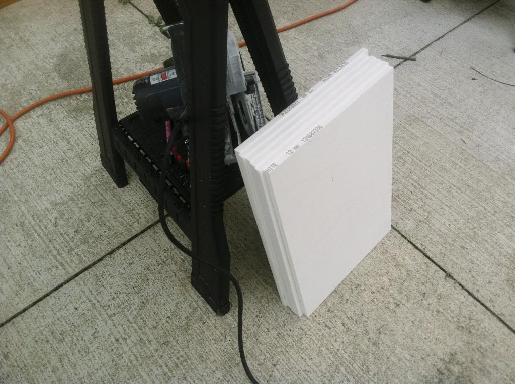

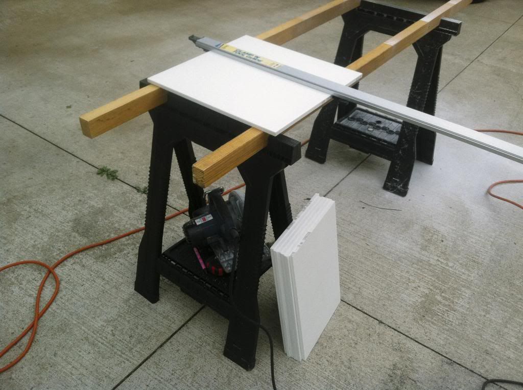

                            MATERIAL
                            As I stated before, I stumbled upon some 1/2" Glacier White Corian from a friend who had just completed a kitchen remodel. After doing a bit of research, I realized that there just wasn't very much information regarding Corian (and especially Corian speaker building) online. There are a few reasons why...
                            1) Corian is a very expensive material compared to MDF, so it tends to be cost prohibitive.
                            2) You need to be certified to purchase Corian material and the specialty adhesive necessary to get a seamless look (more on that later).
                            Having said that, Corian makes a fantastic cabinet as it is extremely dense material, and cuts/shapes easily.
                            Cutting material to fit on CNC

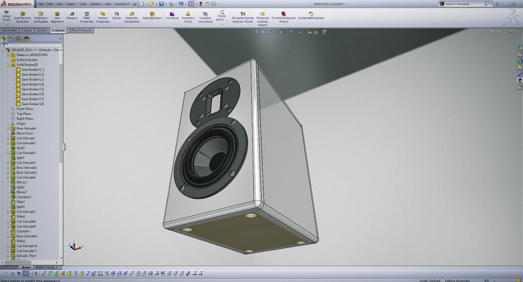

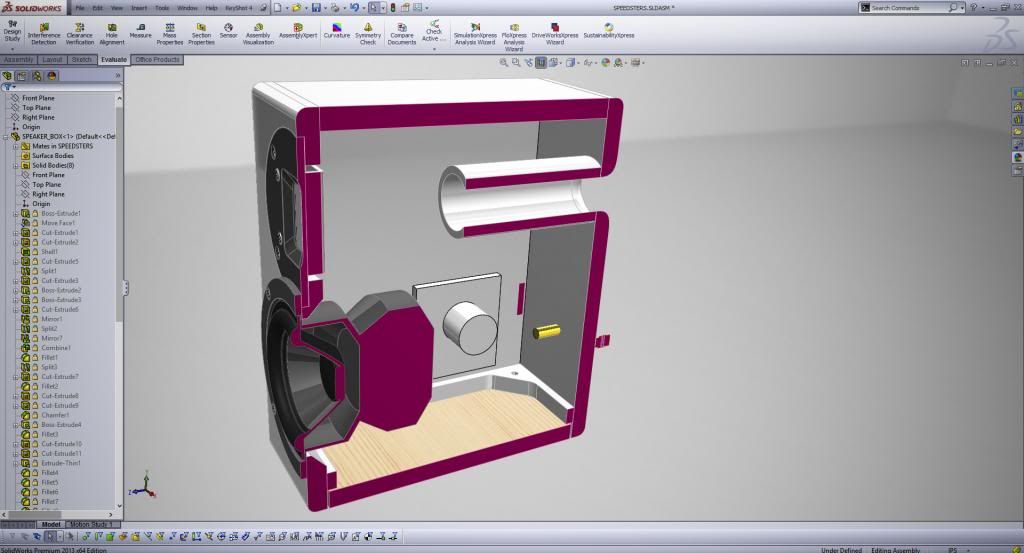

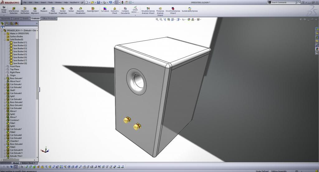

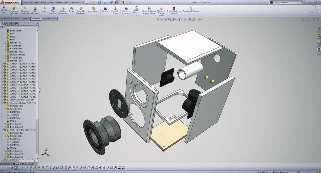

                              DESIGN
                              All design for this project was done in Solidworks. Cabs were designed to spec, and all non-fabricated components were measured and modeled to ensure a perfect fit. Overall design intent was to have a really minimal design with a focus on the Corian material, and a "Monolithic" or "Unibody" design. Removable wood panel was hidden on the bottom, and the bass port was machined into the rear panel.

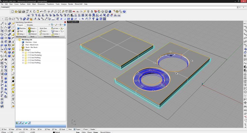

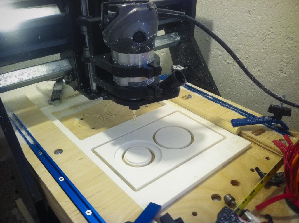

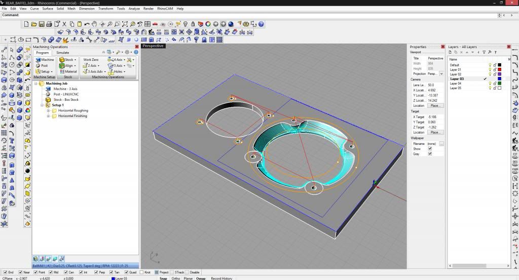

                              Individual Parts were imported into Rhino CAM to translate 3d Data to Toolpaths that can be read by the CNC.

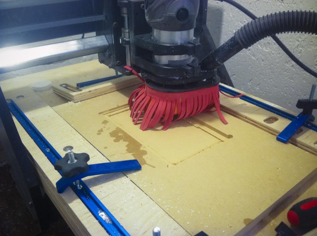

                              Front Baffle (side one) Being cut on CNC using a 1/4 Carbide tip end mil.
                              Video of Cut
                              Check to ensure proper fit

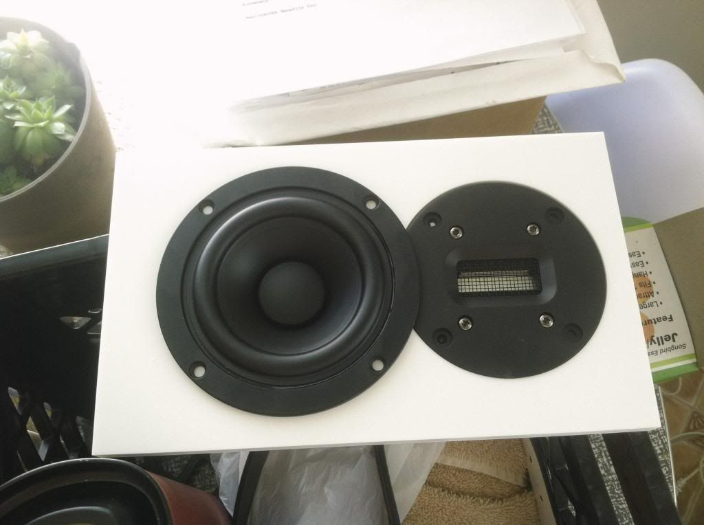

                              Front Baffle (Side two) Cutting an alignment fixture to ensure perfect alignment of side two cut
                              Toolpath for Driver "breathing room"
                              Cutting Baffle side two
