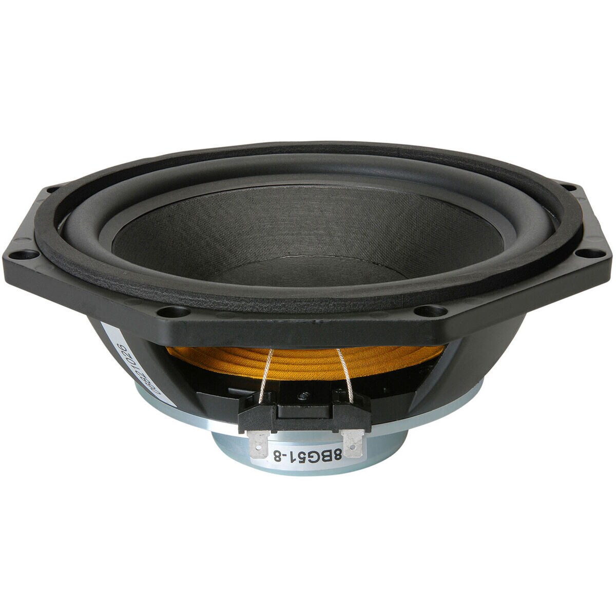

    Pete earlier in the thread you said you got the last pair of the BC woofers,
    was P/E just out of stock and will they be available in the near future?
    They were just the last of the current stock. If you go to the 8BG51 page at PE, it says they'll have more next week.
    B&C 8BG51 8" Neodymium WooferB&C's 8BG51 8" neodymium woofer is fitted with an optimized paper cone and rubber half-roll surround, and strikes a fine balance between bass output and overall efficiency. The 8BG51's ventilated voice coil gap ensures long term power handling and reduced power compression, and a copper cap on the pole piece reduces high frequency-degrading inductance. Highly recommended for compact 2-way speaker systems.
