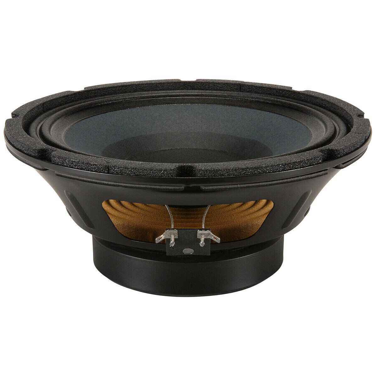

      Woofer and a tweeter make some retro party speakers
      Eminence Beta-10CX 10" Coaxial DriverThe Eminence Beta-10CX 10" Coaxial Driver is recommended for professional audio midrange reproduction in sealed loudspeaker enclosures. Also suitable for midbass or floor monitor applications in vented 2-way speaker cabinets. The Beta-10CX's coaxial design facilitates use of an HF driver to extend frequency response. Standard 1-3/8"-18 TPI threaded insert for HF horn driver (sold separately). Made in the USA. 7-year manufacturer's warranty!Featured in Eminence's "Using coaxial products for DIY monitors and home hi-fi applications" article.

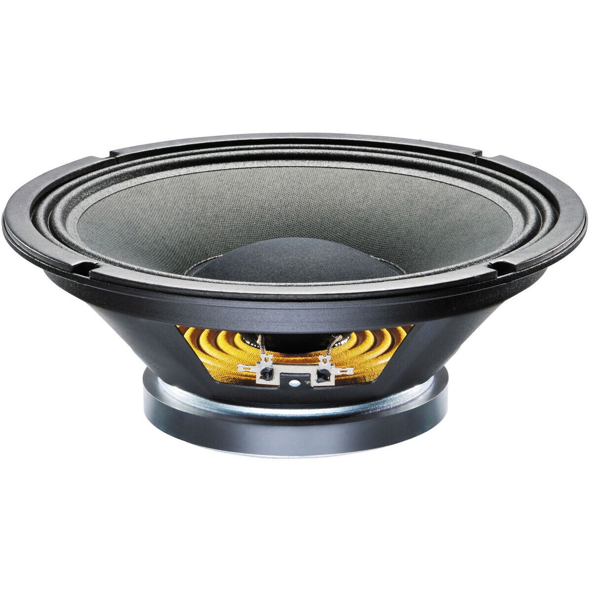

        Welcome The link above seems like a good choice. These two would also work, but will need a tweeter for full range use: http://www.parts-express.com/dayton-...oofer--295-030
        Celestion TF1018 10" Professional Speaker 100WThe Celestion TF1018 10" pro speaker features a durable stamped steel frame, 1.75" high-temp voice coil, and 31 oz. ceramic ferrite magnet. Its wide range response, good efficiency, and durable construction make it an ideal choice for 2-way and 3-way PA loudspeaker systems.
        Those cabinets looked larger for 8 liters, the volume I got with the dimensions provided was 1560ci, or about .90ft, which is usable. I like the guitar amp idea bolland mentioned.
