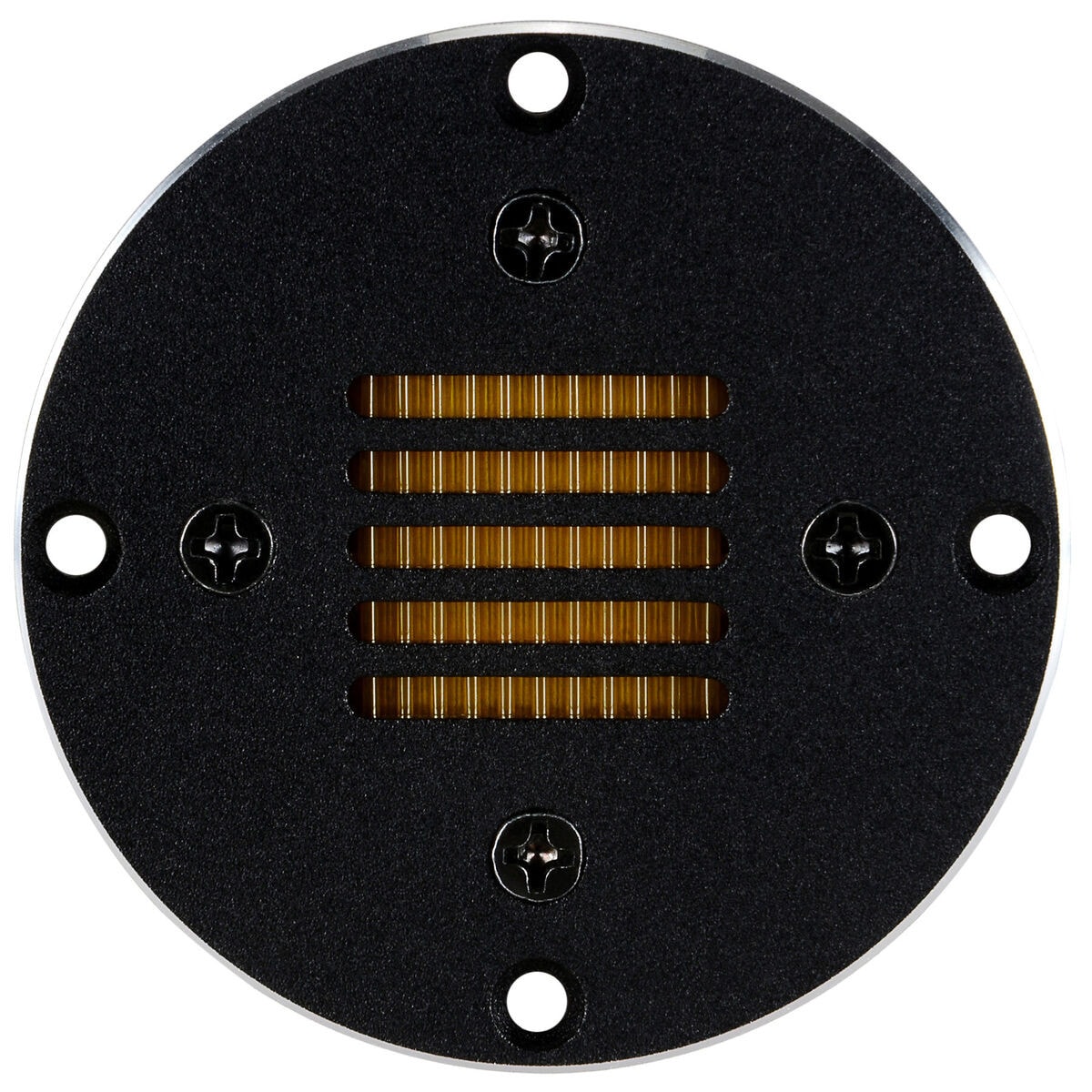

    I just bought a pair of these for my father for Christmas, and couldn't resist hooking them up to the little T amp included in the "bundle" and I have to say, they aren't awful. In fact, I think they do have some possible room for improvement. What do you think about replacing the tweeter with the inexpensive Dayton Air Motion Transformer tweeter? And then replacing the woofer with either the 6 1/2" buyout woofer, or possibly something else. (I have some Vifa P17's and P18's and some Chinese knockoffs laying around...I know it's probably not worth it....but I want to go for it anyway. Any ideas, or comments? What do you guys think the Dayton AMT tweeter would do for the sound? Could they keep up? Is the "buyout" 6 1/2" poly mid-bass an "upgrade" or am I simply stepping sideways?
    What about crossover? I understand the buyout woofer can be run without any crossover, what would you put on the AMT? Anyone have a design for a crossover to these which would work? Just textbook is fine, and I guess a high order is best?
    Any help in improving the B652 is greatly appreciated...plus it's a little project I could do with my Dad, who is in a Retirement Home, but still loves excellent sound. I made a pair of Zaph Bargain MTM's using the MCM 55-1855 and Seas tweeter, which he loved, but he couldn't have the 100 watt per side receiver and those speakers in his room......but I think this little setup will be just fine....I just want it to sound as good as possible without breaking the bank...
    Oh....I do know of Zaph's crossover changes, but that is for a different version of these speakers than current production,,,,or maybe I could try them....oh and how about the buyout tweeters ...they are 2 7/8", but may be the same tweeter already in the BR......I just am looking for ideas...

    I believe the 6 1/2" buyout driver is the same driver used in the B652s. A tweeter replacement would mean a new crossover would need to be designed.

        OK......but IF a guy were to buy the el cheao Dayton AMT's, what would the textbook crossover components be? I am assuming running the woofer either as is, or running it with no crossover...in other words,crossing over and protecting the Dayton AMT's at what point, and using what components?

          If the link below goes to the tweeters you are talking about, look at the review by Doc Jones, who used these as additional super-tweeters in the B652 and describes his crossover and the stand. He likes 'em.
          Dayton Audio AMT Mini-8 Air Motion Transformer Tweeter 8 OhmThe Dayton Audio AMT Mini-8 model features a round housing and compact AMT element, for wide dispersion that easily replaces dome tweeters in retrofit or new design applications. The AMT Mini-8 is small enough to be used in compact satellite speakers, or installed in the center of a mid-woofer to create a full-bandwidth coaxial driver, or implemented in other ways -- including line arrays. The sealed rear chamber design of the AMT Mini-8 eliminates the need for a separate internal chamber in the loudspeaker enclosure.Dayton Audio AMT (Air Motion Transformer) tweeters use groundbreaking transducer technology from the original Heil Air Motion Transformer to provide ultra-clean, detailed, and dynamic treble output. The pleated ribbon diaphragm of an AMT provides a large acoustic radiating area condensed into a compact chassis, for extremely high output and improved power handling.

            I'm not sure I would add a tweeter that costs more than the speakers... I built .5 cf boxes for mine. Big improvement. If they are still the same as the ones I bought 3 years ago then they just have a cap on the tweeter. Adding a L-pad or just a resister before the cap can bring down the tweeter level if it is needed.
