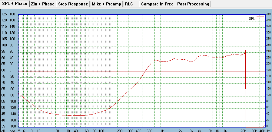

                            Had a chance to play with the Aurum Cantus AST2560 air motion tweeter. I took the felt off the back, built small enclosure behind maybe 2" deep, and filled it with that denim stuffing from HD. Here is the response on 8" x 14" baffle from the Dayton .38cf cabinet that I've been using:
                            The dip at 3khz and peak at 4-5khz is baffle diffraction and will be easily corrected on a baffle for a final design. I've only been able to compare to the Peerless HDS, both crossing 2.5khz LR4 and matched to the Scan Disco woofer I've been using (and growing very fond of). These are very well behaved tweeters. No weird resonances, no sibilance or splashiness, just very calm. Decently open sounding. I think it gives up a bit of musicality *at times* to the HDS, but only in the areas where the HDS excels past everything I've heard anyway: bells, plucked strings, *some* female vocals and piano. But everywhere the HDS falls short, the AST2560 is just playing along calmly. Integrates well with the woofer and doesn't bring attention to itself. I would say better behaved than maybe even the RS28A, but more open and dry sounding.

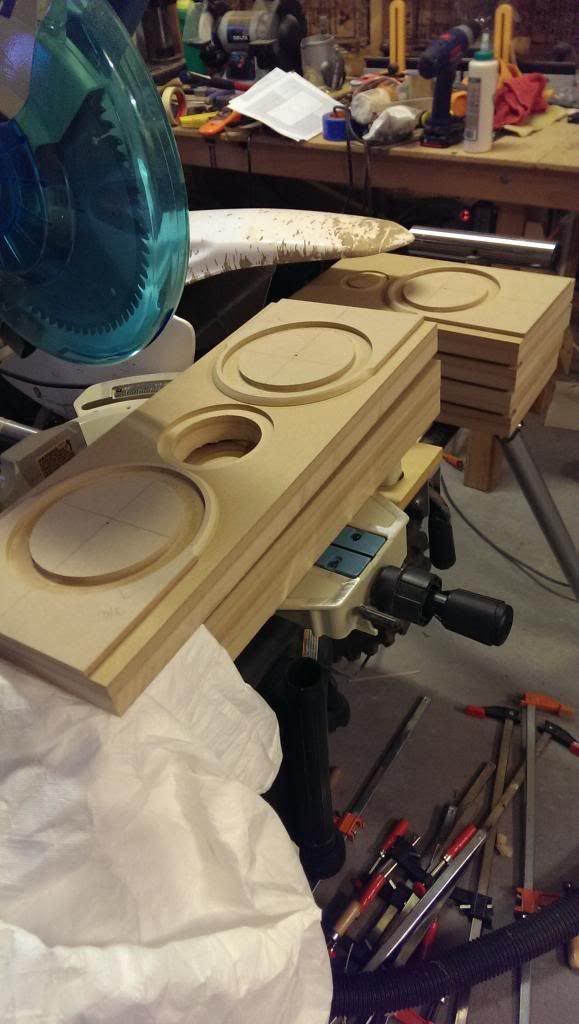

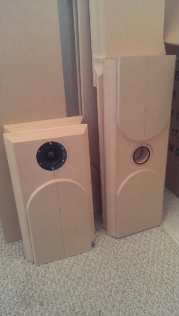

                              Transducer Labs tweeters are on the way! Will be interesting to see how they compare to the AC AST2560 and Scan HDS (just replaced my Peerless HDS with the Scans on the off chance there has been a modification improvement). Hope they are a real step up and end up in my 3-way using the TangBand 3" dome mid.
                              And the final designs that resulted from this thread are being fabbed as we speak, here are about half the baffles:
                              Several flavors depending on what my friends decide to do, Silverflute woofer & SB26STCN in MTM, SBA poly cone & SB26STCN in TM and MTM, Scan Disco & HDS in TM and MTM, and possibly SBA poly cone & HDS in TM and/or MTM.
