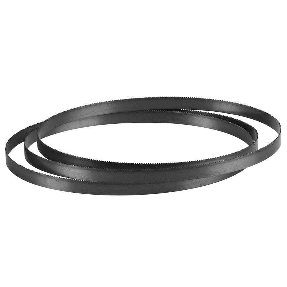

                  18 TPI sounds low not sure if they make a 24 or higher:
                  An advanced laser-cutting machine cuts each Vermont American band saw blade to exacting specifications. We employ a unique micro view inspection system to ensure consistently high quality.

                    Your blade speed is way higher than ideal for metal cutting (wood cutting bandsaw), so fewer teeth are in order.
                    10-12 might even be appropriate for a small tweeter like that.
                    If the saw was operating at typical metal cutting speed then more teeth would generally be in order.
                    18 will probably work ok, tho. It should leave a good finish on all but the dome.
                    Might want to house that little thing in a jig or something. Hate to hear about injuries...
