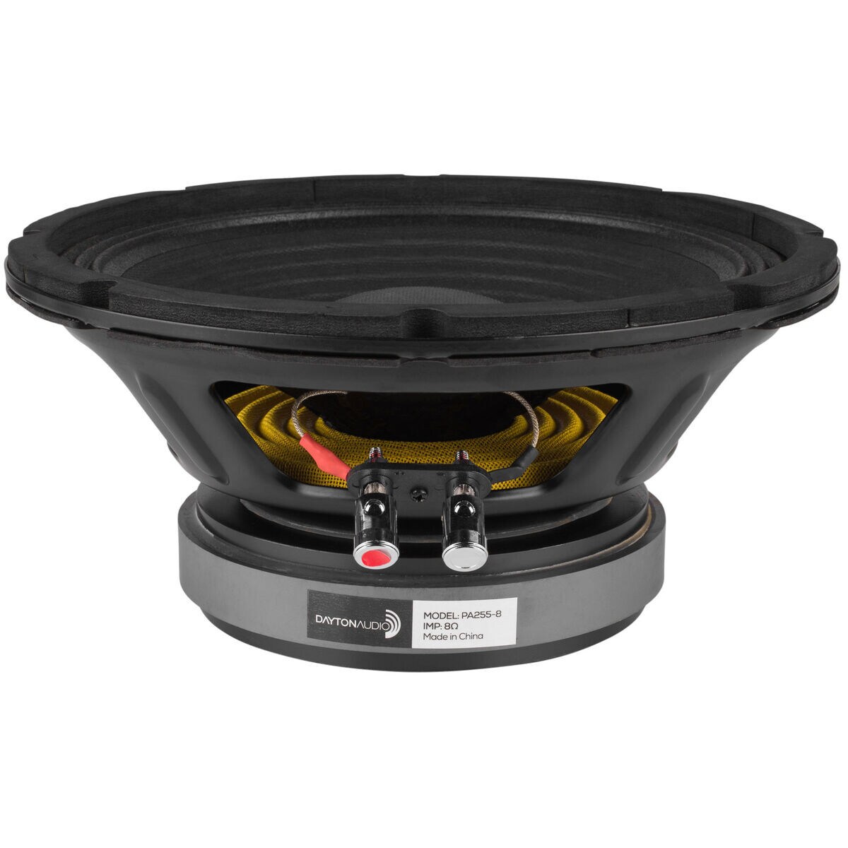

    Which of these 3 drivers do you guys think represents the best price/performance ratio for a sealed bass guitar cabinet?
    Dayton Audio PA255-8 10" Pro Woofer 8 OhmDayton Audio PA Series Pro Woofers are a great upgrade for musical instrument or sound reinforcement cabinets, and also excel in custom-built speaker systems. High power handling, smooth response, low distortion, deep punchy bass, and rugged reliability are the features that set PA Series woofers apart from other drivers – premium performance, but value priced.
