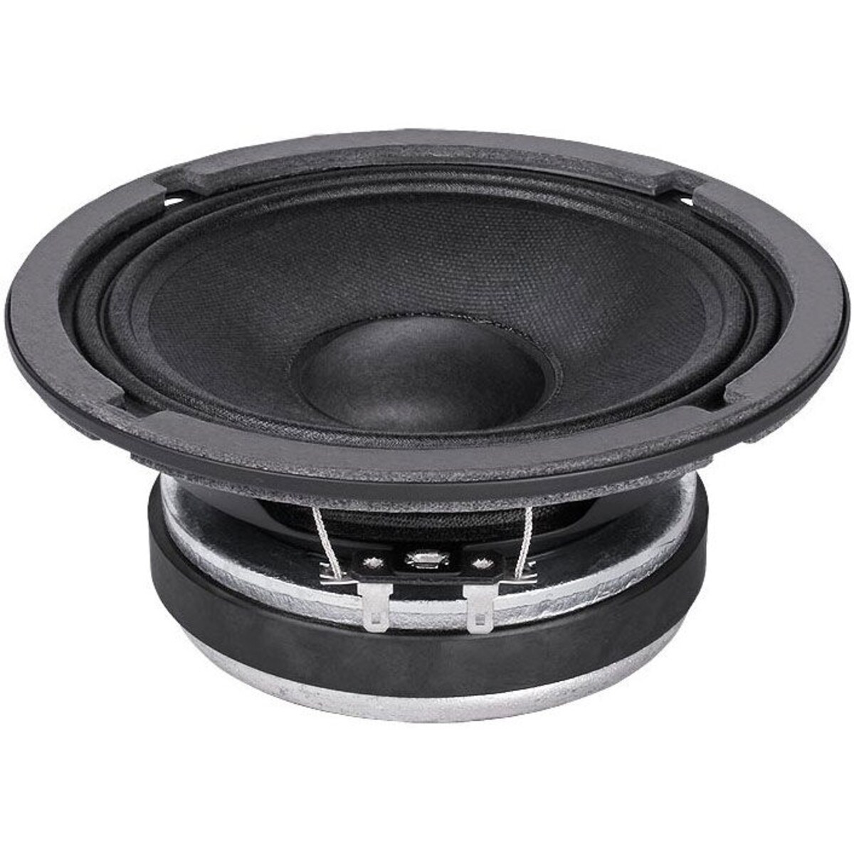

      FaitalPRO 6FE200 6" Professional Midrange Speaker 4 OhmFaitalPRO's open back 6FE200 6" professional midrange speaker is purpose-built to cover the critical midrange in three-way speakers, but also works great as a door speaker in car audio applications. To ensure absolute signal fidelity, FaitalPRO built the 6FE200 with a strong ferrite ring-powered motor. Not only does this increase sensitivity, it keeps the Qts at a respectable figure of 0.71. Made in Italy.
