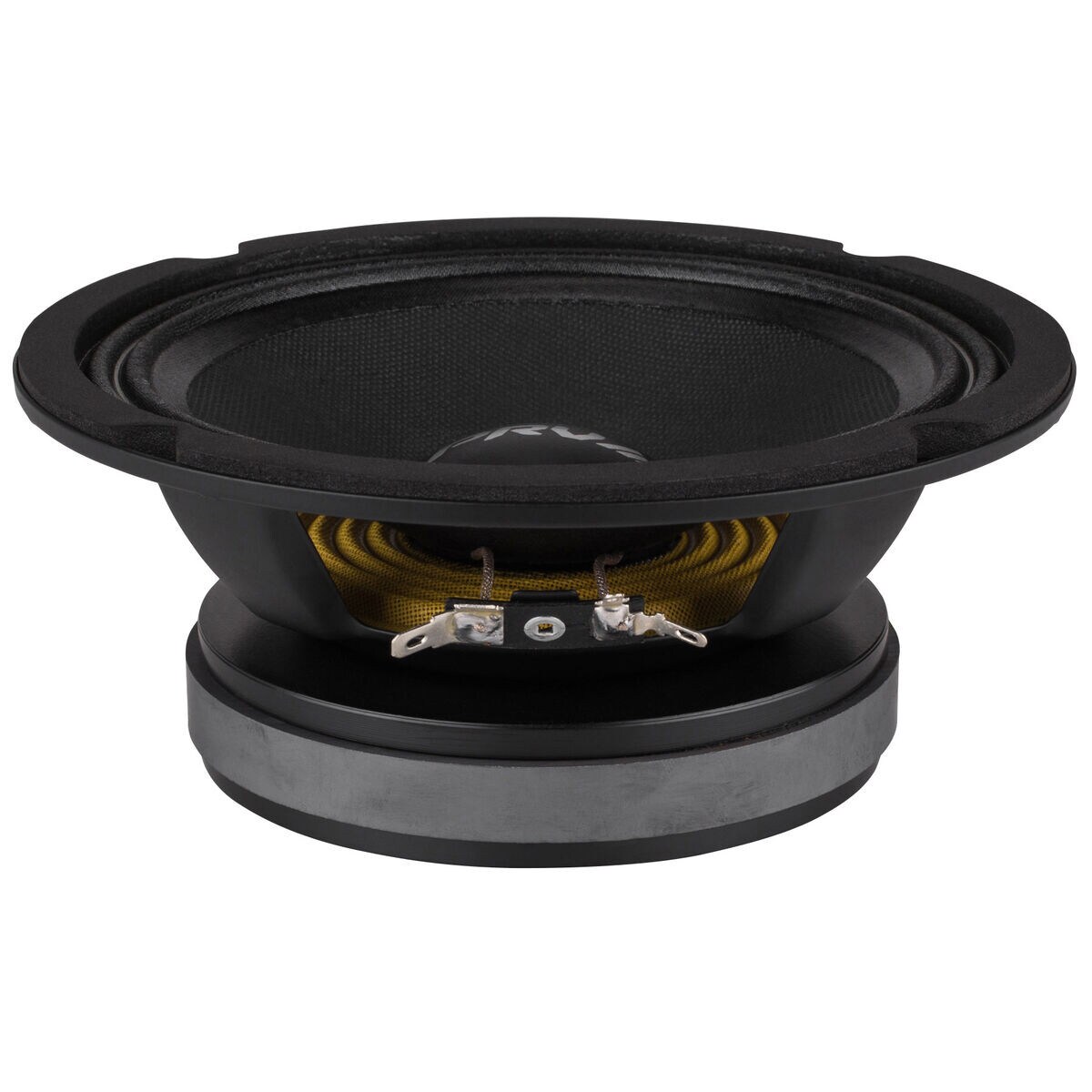

            Has anyone looked at these as Mid contenders?:
            PRV Audio 6MB200 6-1/2" Midbass Speaker 8 OhmPRV Audio's 6MB200 6-1/2" midbass woofer offers punchy midbass combined with a smooth midrange and response up to 4,500 Hz. The size and punch of this pro audio driver makes it perfect for use as a midrange driver in a 3-way loudspeaker cabinet or as a woofer in your studio monitor.A thick, yet light and rigid paper cone, 1.5" voice coil, durable spider suspension, and a woven surround supported by a sturdy steel basket. All of this ensures its ability to withstand long hours of operation making this driver a popular speaker choice amongst high output car audio enthusiasts.

                  That looks like it would do a good job. Has anyone tried it out. Nice smooth response but makes me wonder a little how much smoothing is applied.
                  If that response is for real it would be pretty amazing. No breakup at all really. Good price too.
                  http://www.parts-express.com/prv-aud...-ohm--294-2700
