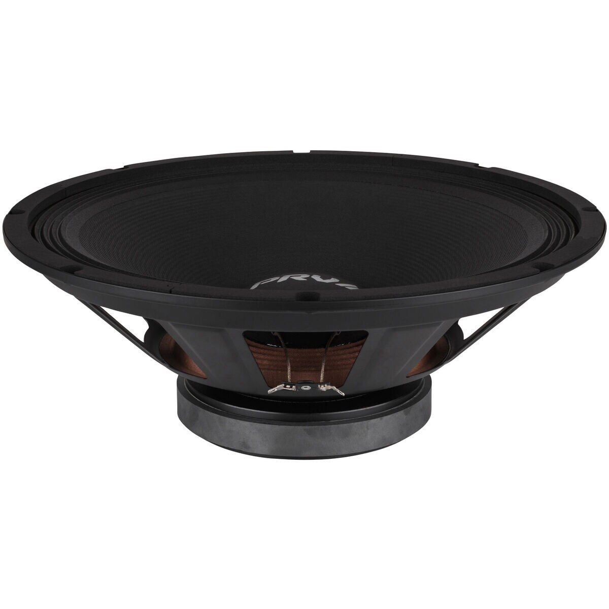

    Originally posted by OlderMongrel View Post
    For any lurkers who like the idea but are willing to go bigger, take a look at this PRV 15 ($68.99; fs = 30, Qts = .59, Vas = 7.92 ft3)...
    PRV Audio 15W700 15" High Power PA Woofer 8 OhmThe PRV Audio 15W700 15" professional audio woofer is designed to be a perfect drop-in replacement for many popular PA speaker cabinets and works equally well in ported or sealed cabinets. A ribbed paper cone is employed to give you the classic tone associated with many high-end speakers.Moving to the motor, you'll find features not normally associated with other drivers at this price point: a 3" diameter voice coil with a Kapton® former and 5.5 mm of Xmax, high sensitivity, and a fairly low free-air resonance that allows this driver to play down below 40 Hertz. A specially designed resin was been applied to the woven spider for increased longevity, and the cloth accordion surround ensures smooth, accurate sound.
    12 ft3 sealed gets you down to 30 @ -6db. You can go vented, you can go smaller (more ripple of course). Then again you could run 2 in 24 ft3...for those of us in a position to regard ManCave and WAF as pertaining to separate magisteria.
    John
