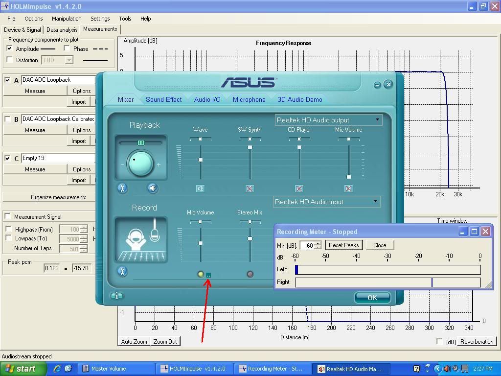

    Looks like the soundcard is the problem. What kind is it? Did you turn off all the special effects?
    its my internal laptop . best i can tell all effects re off and sample rates for playback and mic set to 48k ...

      Somewhere there may be a setting that tells the soundcard to take whatever signal comes into the mic, and send it out the output. This has to be turned off. Otherwise when the mic picks up say the 300 hz sweep signal after a 4ms delay, the soundcard mixes that signal back into the signal being sent to the speaker while its trying to produce 500 hz. So the signal sent to the speaker is corrupted. I made up the numbers, but hopefully you understand the idea.
      Speak into the mic, and see if you hear your voice come out of the speaker. It should not!
      Look at this soundcard output settings. I have the mic input turned off. This may be your issue, or one of them anyway.

          Check the edit above, and this picture.
          Your card might have a line in as well as a mic in. One of my cards or computers worked better with one than the other. I'm not sure which. I believe it was a computer that I no longer have or use.
