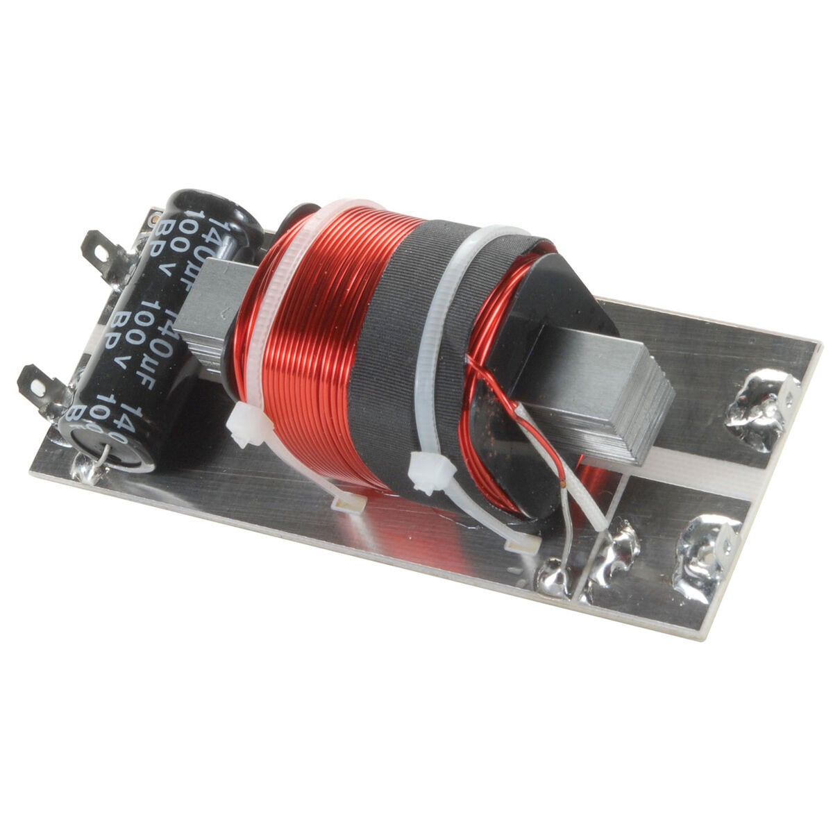

                      • I use these at around 10 bucks each so $20.00 for a pair. 800 Hz Low Pass 8 Ohm Crossover (parts-express.com) The P.E. crossovers utilize butterworth type while Dayton uses Linkwitz. But for my application the Butterworth sounds better.

                        • I didn't realize PE had assembled crossovers. Looks like a nice selection. I think the 100 hz low pass might be the one for me to try for the cone woofer I'll be using. I'm hoping the 6 x 14 panel will drop down low enough to blend successfully with the woofer crossing at 100. I want to have the panel play the dominant role in the very low mids up through what ever it will go up to.
                          https://www.parts-express.com/100-Hz...ssover-266-446
                          Comment
                          • Although the panel can play 100hz it will be at a lower db as it starts to drop sharply at around 100hz. This is the reason I use the P.E. 800hz low pass as the woofer will cover lower mids while the DML handles the high mids to high frequencies. Plus the higher the DML panel is crossed the less strain on the exciter.
                            Comment
                            • That makes sense. Do you know if P.E. can sell the laminated core inductors used in their crossovers? I would like to experiment with a second order 400 hz low pass but is not one offered in an assembled crossover. Everywhere I've looked for inductors whether air core or iron/ferrite, the prices are way higher than what P.E. sells their 2nd order crossovers.
                              Comment
