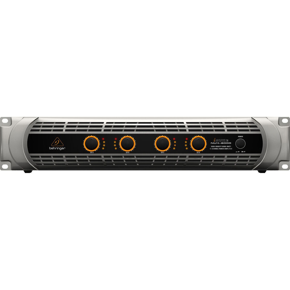

                              Well, that is if you go the active route. And with active you don't need crossover components because the amps have DSP built-in.
                              The passive route will be $170 x 2 for the subwoofers, and then some crossover components ($$$). This will likely be cheaper, but won't have as great of volume/output potential.
                              Also once he gets the crossover finalized, there may be a cheaper way to do this same thing. Using a 4-channel mini DSP and a 2-channel amp such as the Crown XLS-1000 to power both (bass) sides. There is more than one way to skin a cat, since most people already have a 2-channel amp.
                              This: http://www.minidsp.com/products/mini...ox/minidsp-2x4
                              Plus this for power: http://www.parts-express.com/crown-x...-ohms--245-500
                              OR, just get this amplifier and it will do everything once you program the DSP:
                              Behringer iNUKE NU4-6000 6000 Watt Four Channel Power AmplifierThe powerful iNUKE NU4-6000 packs four 1500 watt amplifiers into the space of one. Now you can run your stereo full range mains plus two separate monitor mixes with this one exceptionally lightweight, rack-mountable powerhouse. Or, you may want to operate your subwoofers in bridge mode (3000 W) and run your mid/high packs in mono biamp mode (2 x 1500W). The highly versatile iNUKE NU4-6000 gives you options, and lots of them. Their revolutionary high-density Class-D technology combined with ultra-efficient switch-mode power supplies ensures these feather-light power amps will drive your rig effortlessly for many years to come. Superb transient response Behringer spent years fine-tuning the high-density Class-D technology that gives the iNUKE Series its oomph. By carefully selecting transistors with extremely high slew rates and optimizing other proprietary parts of the circuitry, these amps react instantly to even the most demanding electronic bass impulses. When this amazing amplifier technology is combined with state-of-the-art switching-mode power supplies, these amplifiers provide tremendous punch. And because they are so much more efficient than conventional designs, they run cooler and don’t require the massive heat sinks and heavy toroid transformers typically associated with their conventional counterparts. Sublimely simple operation The front panel controls and indicators provide your system's vital signs at a glance. After pressing the Power button, the Power LED lights to show the amp is ready for action. All channels feature positive-detent Gain controls with Signal LEDs that light when a signal is present, as well as Clip LEDs to indicate when the signal is distorted and you need to reduce the input signal. The rear panel is just as elegant, with combo XLR and 1/4" TRS input connectors making the NU4-6000 compatible with virtually any source, balanced or unbalanced. Professional twist-lock speaker sockets are provided to ensure every drop of output power gets to your loudspeakers. The rear panel is also where you'll find the switches that enable the NU4-6000 to work in quad mono, dual stereo, or dual mono bridge mode. A built-in crossover switch enables the amp to operate in biamp mode, sending low frequency content to passive subwoofers, while the high frequency output is channeled to full range loudspeakers. Specifications: • Output power (per channel, four channels): 315 watts RMS, 440 watts peak (8 ohms), 680 watts RMS, 860 watts peak (4 ohms), 1040 watts RMS, 1600 watts peak (2 ohms) • Output power (per channel pair, bridge mono): 1250 watts RMS, 1600 watts peak (8 ohms), 2050 watts RMS, 3000 watts peak (4 ohms) • Frequency response: 20 - 20,000 Hz, +0/-2 dB • Distortion: < 0.2% • Signal-to-noise ratio: > 100 dB • Power supply: 120V, 60 Hz • Dimensions: 3.5" H x 19" W x 12.2" D (95 x 482 x 310 mm) • Weight: 12.4 lbs. SpecificationsQ&AReviewsManuals & Resources
                              The iNukes are pretty good amps although you'd probably want to change out the fan for something quieter.
                              But it's Jeff's design. Since he doesn't make a profit on publishing these designs he'd probably be happy with whatever works.
