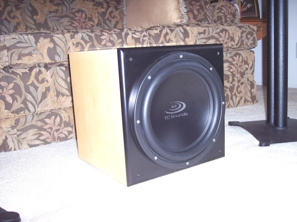

    I designed a 1 cu ft sub in the PE prefab cabinet several years ago wanting to use the
    TC Epic 12" but it was not sold here, at that time, and I also wanted to use an XBL motor so I went
    with the CSS Trio 12" which has worked well. I actually pushed PE to carry the TC line.

      As I said, built it, actually a pair with the CSS Trio 12", as stated 1 cu ft box 500W Dayton plate amp.
      Interested in another build.

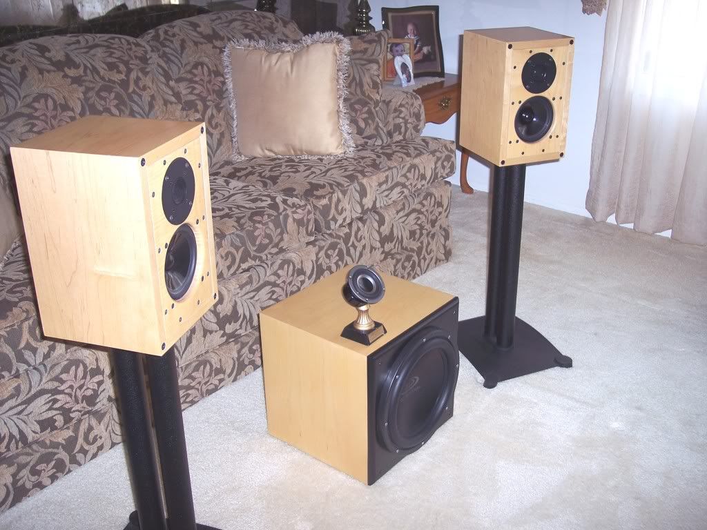

          Hey, You just described my Continuum Subwoofer that I took to the 2012 MWAF and won the unlimited category.
