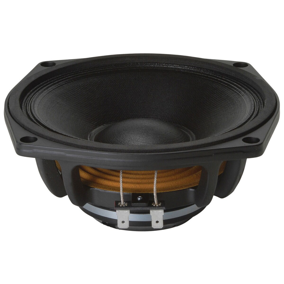

                        B&C 6PEV13 6-1/2" Midrange SpeakerB&C's 6PEV13 6-1/2" midrange speaker features great sensitivity and very smooth response from 400 Hz to 8 kHz. An aluminum phase plug increases the 6PEV13's axial sensitivity and controls its high frequency dispersion. Aluminum voice coil on fiberglass former.
                        B&C 6MDN44 6-1/2" Neodymium Midrange SpeakerB&C's 6MDN44 6-1/2" speaker was designed for professional midrange applications that require high output and low distortion. The 6MDN44's powerful neodymium magnet reduces driver weight while maintaining superb efficiency, complemented by a short, low-mass aluminum voice coil. An aluminum demodulation ring in the motor circuit reduces distortion.
                        B&C makes some nice drivers.
