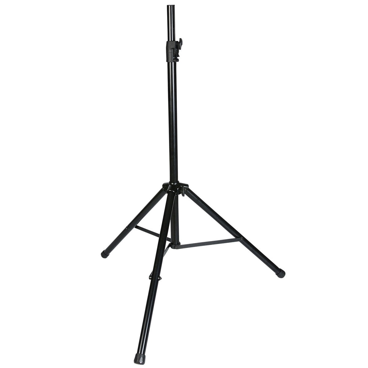

    Talent stand
    Talent SD70 Super Duty Tripod Speaker Stand with Air BrakeTalent's SD70 super duty speaker stand is ideal for the Pro Audio professional. The air brake pneumatic suspension not only makes this stand safe, it combines with the auto-lock push-button lock system for quick and easy speaker height adjustment—and works with speakers up to 110 lbs! Ergonomic adjustment knobs are featured on both the height adjustment and the leg spreader clutch assemblies.The SD70 is manufactured using a 1-3/8" diameter aluminum speaker pole and steel legs to form a high-strength stand that is capable of supporting speakers weighing up to 110 lbs and a 46" tripod base spread offers superior stability. All of this collapses down to a 41-1/2" length that's less than 5" in diameter for extreme portability with the included heavy nylon bag. Last, but not least, the all black finish disappears on-stage. Five-year limited warranty. Specifications: • Speaker pole diameter: 1-3/8" • Stand height: Adjustable from 54" to 80" • Fixed height positions: 54", 58", 62", 68", 72", 76", 80" • Tripod base spread: 46" • Collapsed length: 41-1/2" • Finish: Black • Weight capacity: 110 lbs. • Sold individually.
    Stand mounts
    I've got the stand closed up a bit to fit in the corner. I use a nylon strap to hold the speaker on the stand top. The top is black painted 3/4 inch plywood.

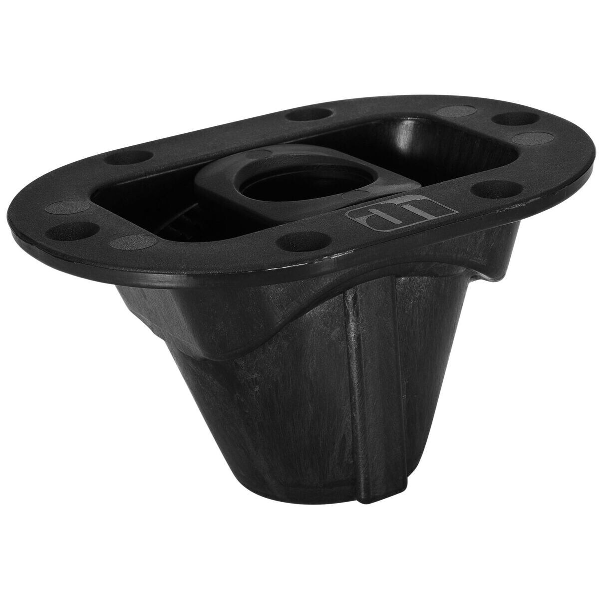

      Thanks John, didn't know they made "top hats". This one looks like it'll work well for performing of axis measurements
      Eminence Top Hat-CH Adjustable Speaker Pole MountAdjustable angle speaker stand receptacle for loudspeaker boxes. Unique spring-loaded socket easily yet securely adjusts speaker tilt. Fits most standard 1-3/8" speaker stands. Black polyamide. Patent pending. • Flange dimensions: 4.57" x 6.46" x 0.20" • Cutout dimensions: 3.15" x 4.75" x 3.25" deep.

        For the top hats, I went with the ones where I could turn the speaker and lock in one position. I had trouble with long heavy speaker wires moving the speaker.
