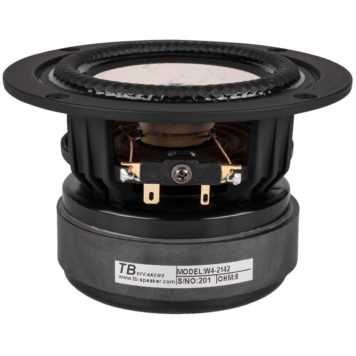

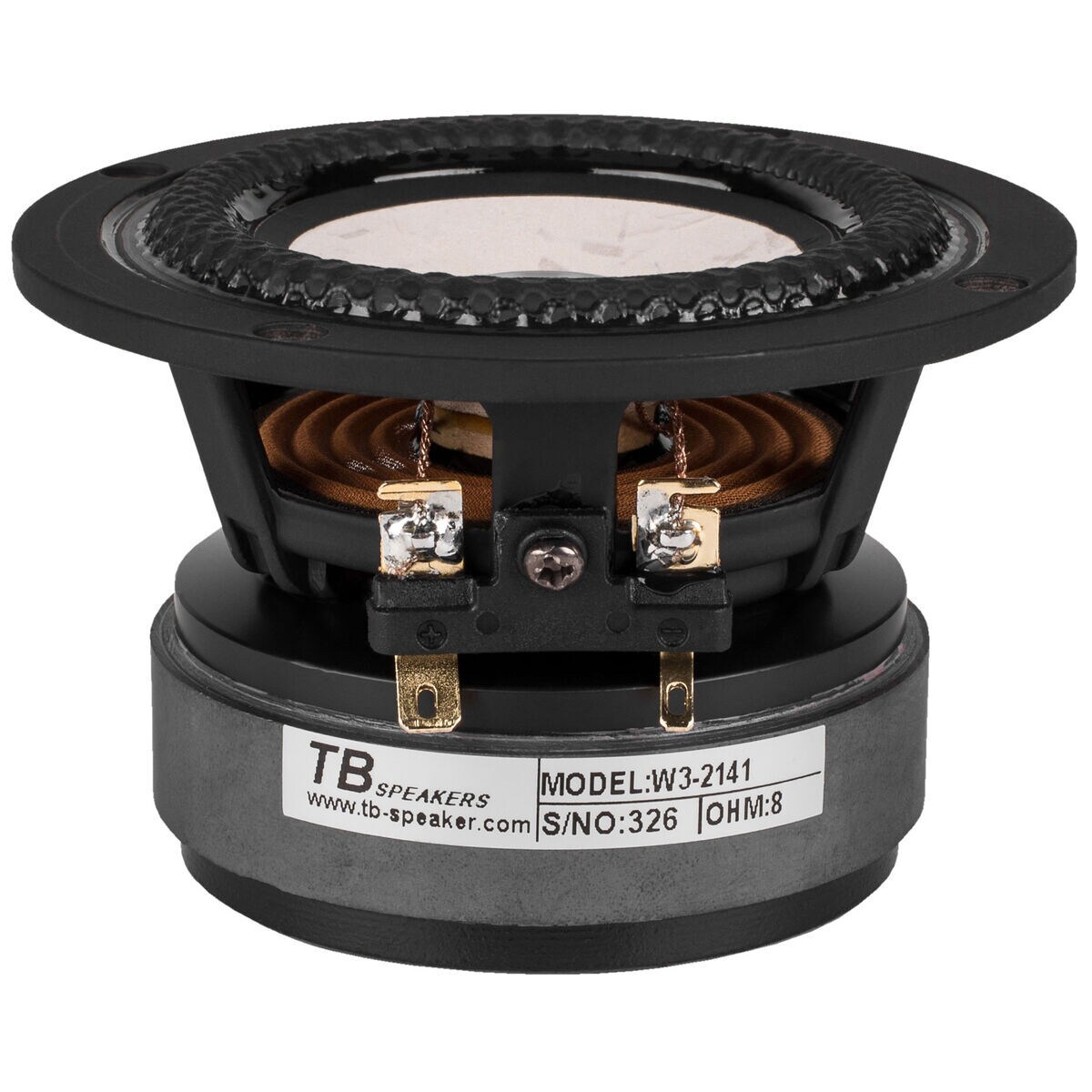

                Hey Ani , would any of the new , smaller full range tang bands fit the bill? I know you mentioned pure mid , but
                Tang Band W3-2141 3" Paper Cone Full Range Driver 8 OhmTang Band's versatile W3-2141 full range driver uses an underhung voice coil, which places the entire coil inside the magnetic gap, for the utmost in control and accuracy. Designed for minimum distortion and resonance, the bamboo fiber paper cone and structured surround produces smooth response without harsh peaks or dips. The aluminum phase plug improves off axis response while also acting as a shorting ring providing greater control of the voice coil resulting in lower distortion.
                Tang Band W4-2142 4" Paper Cone Full Range Driver 8 OhmThis item available through special order only. Minimum order quantity is 50 piecesTang Band's versatile W4-2142 full range driver uses an underhung voice coil, which places the entire coil inside the magnetic gap, for the utmost in control and accuracy. Designed for minimum distortion and resonance, the bamboo fiber paper cone and structured surround produces smooth response without harsh peaks or dips. The aluminum phase plug improves off axis response while also acting as a shorting ring providing greater control of the voice coil resulting in lower distortion.

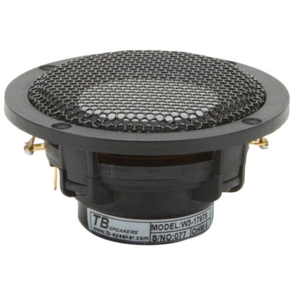

                          This one is my pick:
                          Tang Band W3-1797S 3" Neodymium Midrange DriverThis compact driver features a self-shielding neodymium magnet system, flat aluminum sandwich cone, integrated protective screen, and extremely low second and third order distortion. The Tang Band W3-1797S is intended for full range use as well as dedicated midrange, with very wide dispersion characteristics.Specifications: • Power handling: 25 watts RMS/50 watts max • VCdia: 1-1/4" • Impedance: 4 ohms • Re: 3.6 ohms • Frequency range: 90-20,000 Hz • Fs: 90 Hz • SPL: 85 dB 1W/1m • Vas: 0.04 cu. ft. • Qms: 1.66 • Qes: 0.36 • Qts: 0.29 • Xmax: 1 mm • Dimensions: Overall diameter: 3.66", Cutout diameter: 2.9", Depth: 1.93".
                          88dB at 2.83V, roughly. You may have a small resonance issue at 3k on the 1797, but should be easy to nuke.
